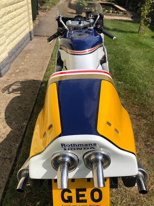

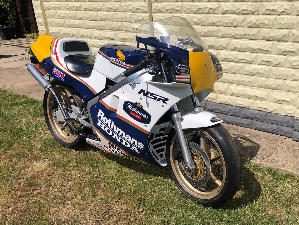

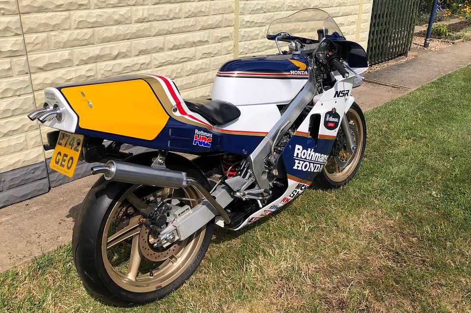

Tue Jun 27, 2023 1:13 pm » Post: #184 » Download Post

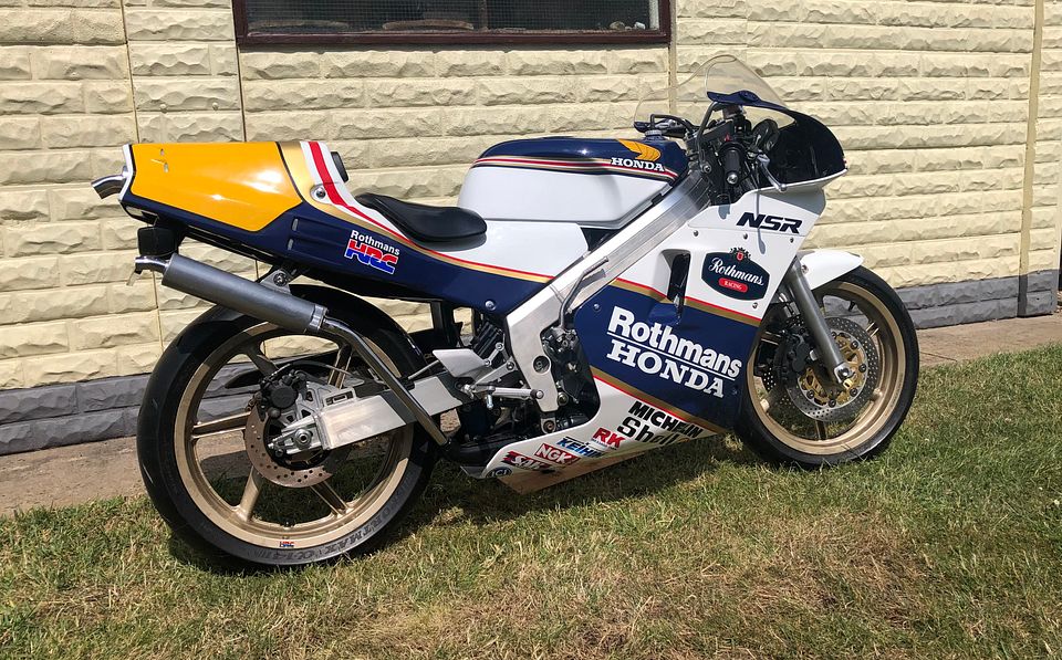

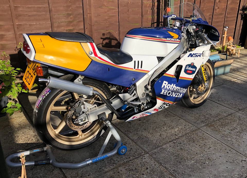

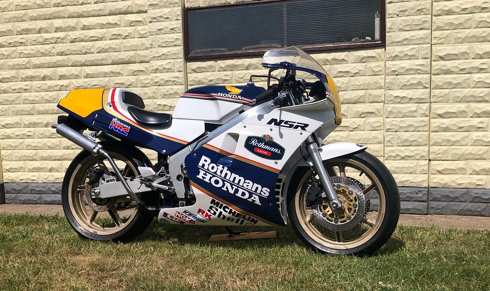

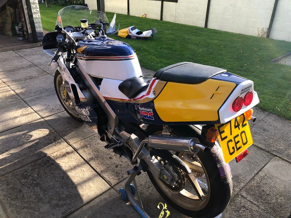

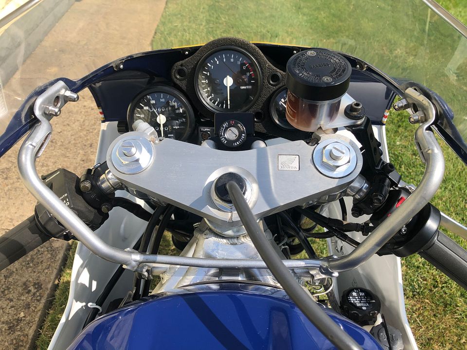

Long overdue update - Still needs a legal plate and a MOT but given its was nice weather I thought I’d take a few pics for posterity.
Other than that it’s getting close to completion - next on the list is decals including the Rothmans logo on the screen, I alao have an earlier single seat conversion with the iconic Shark gills but that needs painting and some light restoration work.
Anyway for now it looks like this….
IMG_2038
IMG_2058
IMG_2056
IMG_2042
IMG_2044
IMG_2050
IMG_2052
IMG_2062
IMG_2061
IMG_2054
IMG_2053
I think you’ll agree - Quite a difference between page 1 and now, also an equal difference with my bank balance between then and now Laughing

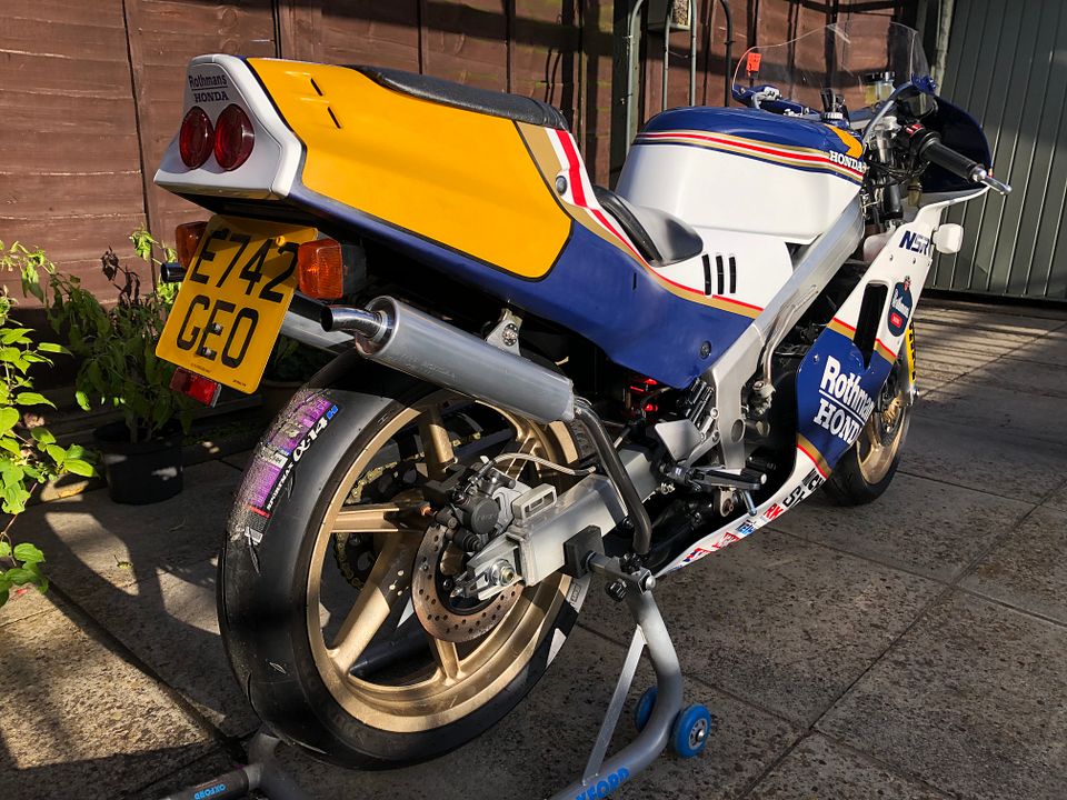

Mon Nov 06, 2023 11:58 am » Post: #192 » Download Post

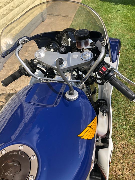

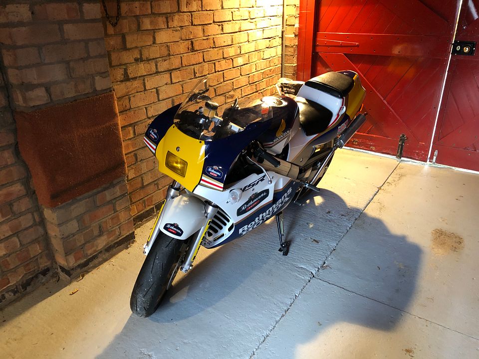

With summer sadly behind us and little sign of progress from me regarding getting this back on the road…. I have to fess up its not due to being unduly slack, but more the case of right royally f**king up and seeking the assistance of the omni present NSR Guru located at GT performance in Plymouth “Saint Steve Alee” to get me back on track.
Following the rebuild the engine sat idle for so long and unbeknown to me the new clutch plates had fused together and having had the engine running many times in the past it wasn’t until I went to put it in gear that the problem was identified and even with the clutch lever fully pulled in the drive to the back wheel was still fully engaged. Rooky error 101!
Steve gave me two options – ship the bike to GT Performance for him to strip down and manually tease the clutch plates apart, brilliant offer but would involve a 300+ mile round trip, or fire up the engine, warm the oil up, switch off and cable tie the clutch lever in and periodically rotate the back wheel to see if the lock could be broken ………I chose the latter and after six weeks it finally yielded and even then for the first few days it wasn’t a happy bunny going into first with a good “Clunk”
Now back in business once more - it was MOT time and after a lot of discussion and push back from various local MOT stations about presenting my bike without lights and at one place being told I’d even have to remove the switch gear as well – I conceded (for the time being at least) to toe the line and reinstate the lights etc and ditch the faux pipes. In doing so the front and rear bodywork has been removed and replaced with the originals and for good measure its also sporting a big ass number plate the same dimensions of an extra-large Domino’s Pizza box – oh and orange rather than black lensed indicators are present once more.
My only concession is I’ve not fitted the NOS mirrors as I can’t bring myself to fit them, however that’s probably going to change if I can’t easily see what’s going on behind me and then were pretty much back to OEM standard before all my nonsense started.
So for the time being my goal of having a faux version of this has been sidelined.
Unknown 4
Now looking rather standard – but never the less still a looker for an old 1980’s girl
IMG_2779
One rear panel is still awaiting HRC decal and Rothmans lettering so paintwork is looking very flat at present without the clear coat.
IMG_2778
IMG_2783
IMG_2785
Quietly awaiting collection…
IMG_2797

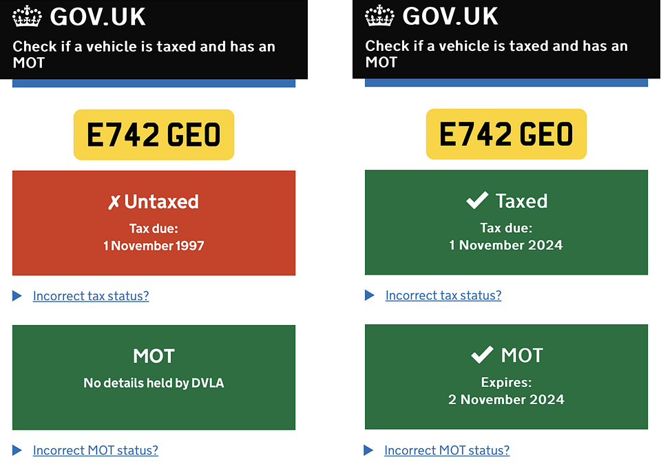

As I was no longer going to push the bike to a local MOT station - Gas Junky Motorcycles in Cheltenham kindly drove over and collected it, after a good look over from Mike who also set up the suspension for my 70kg mass, aligned the headlight beam, balanced the carbs and adjusted the idle speed before duly carrying out its first MOT in 26 years - it’s fully road legal and back in the system once more.
mot and tax
Being old and a 2 stoke the guys at Gas Monkey Motorcycles took a few snaps - way nicer than mine
IMG_2822
IMG_2824
Since I’ve got the original tax disc from 1997 and can’t display a new one - its still going to wear this one with survivors’ pride, I have to confess had it been possible I would have unashamedly gone back to the exact same post office some 26 years later to get the replacement.
