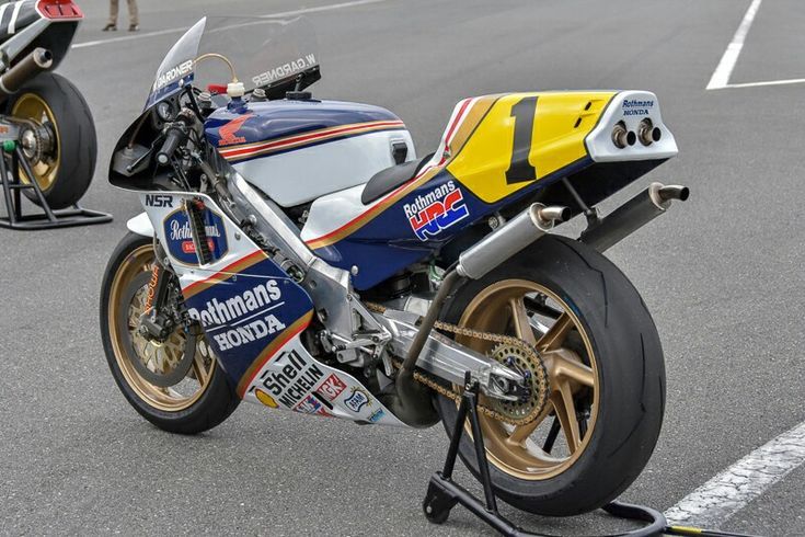

So for the time being my goal of having a faux version of this has been sidelined.

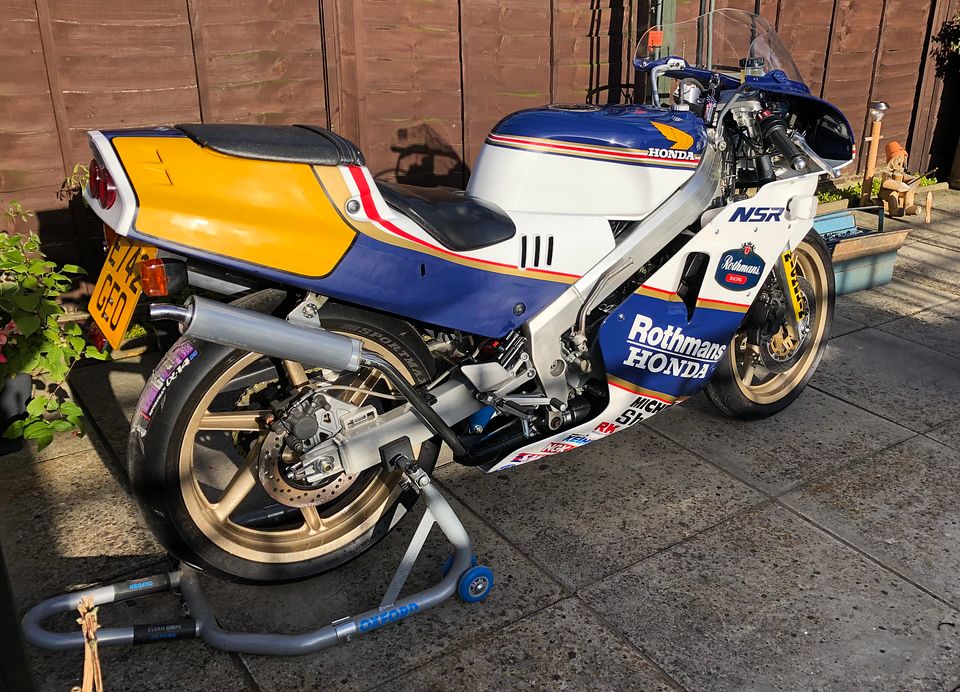

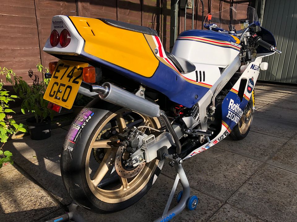

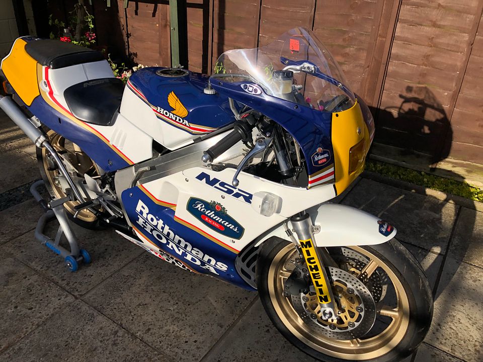

Now looking rather standard – but never the less still a looker for an old 1980’s girl
IMG_2779
One rear panel is still awaiting HRC decal and Rothmans lettering so paintwork is looking very flat at present without the clear coat.
IMG_2778
IMG_2783
IMG_2785

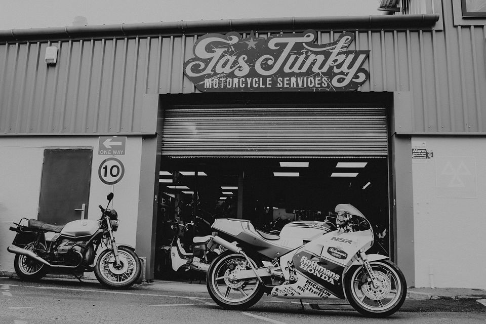

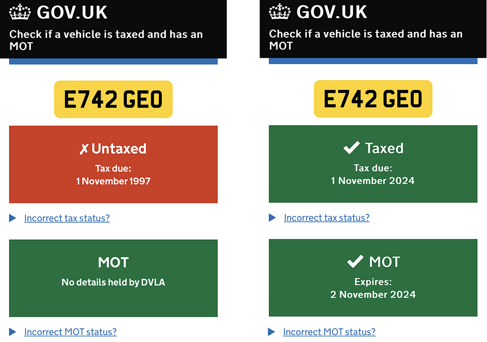

As I was no longer going to push the bike to a local MOT station - Gas Junky Motorcycles in Cheltenham kindly drove over and collected it, after a good look over from Mike who also set up the suspension for my 70kg mass, aligned the headlight beam, balanced the carbs and adjusted the idle speed before duly carrying out its first MOT in 26 years - it’s fully road legal and back in the system once more.
mot and tax
Being old and a 2 stoke the guys at Gas Monkey Motorcycles took a few snaps - way nicer than mine

Since I’ve got the original tax disc from 1997 and can’t display a new one - its still going to wear this one with survivors’ pride, I have to confess had it been possible I would have unashamedly gone back to the exact same post office some 26 years later to get the replacement.
