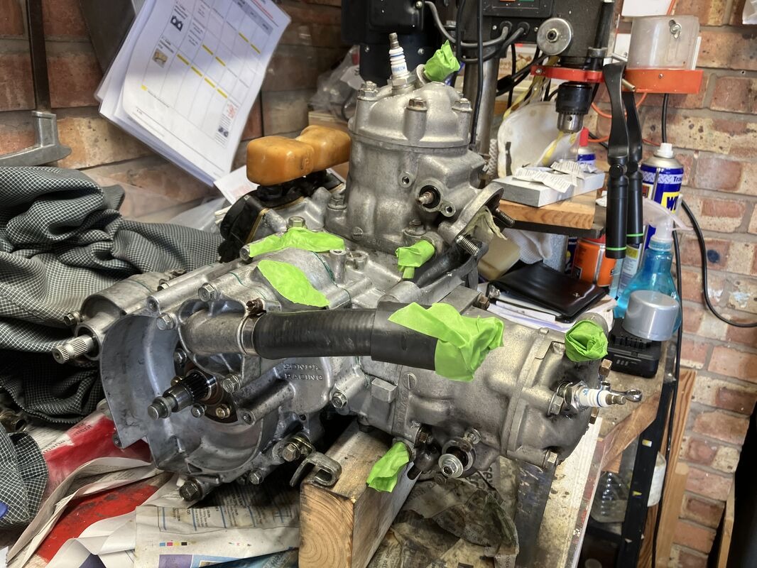

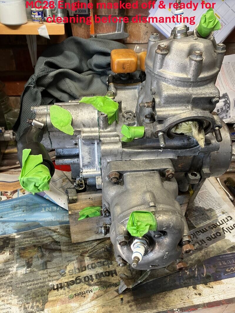

Detailed instructions on the complete Engine strip and rebuild are on the NSR WORLD site which I found extremely useful and as you will see a great deal of similarity. The MC28 Engine was removed for cleaning prior to dismantling & all parts open to any ingress were taped off and sealed.

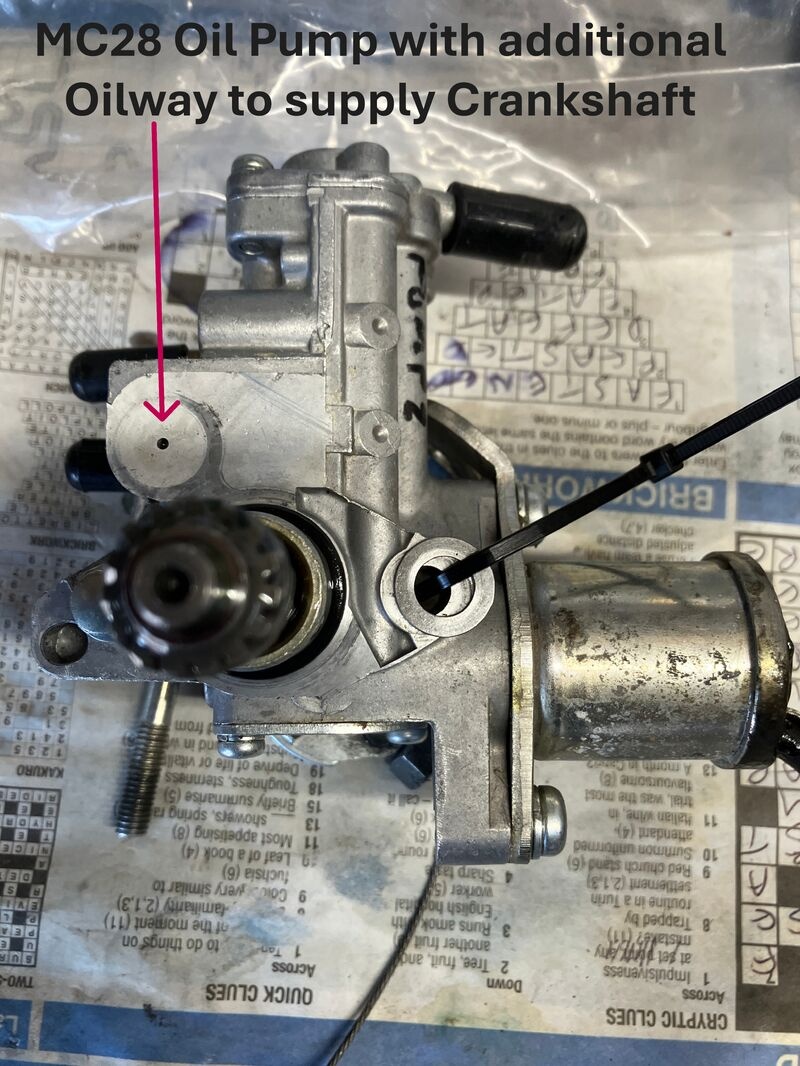

MC28 2T Oil Pump
Although the MC28 2T Oil Pump was removed prior to the Engine removal, I’ve included a Picture detailing the additional Oil Way that isn't present on the MC18.

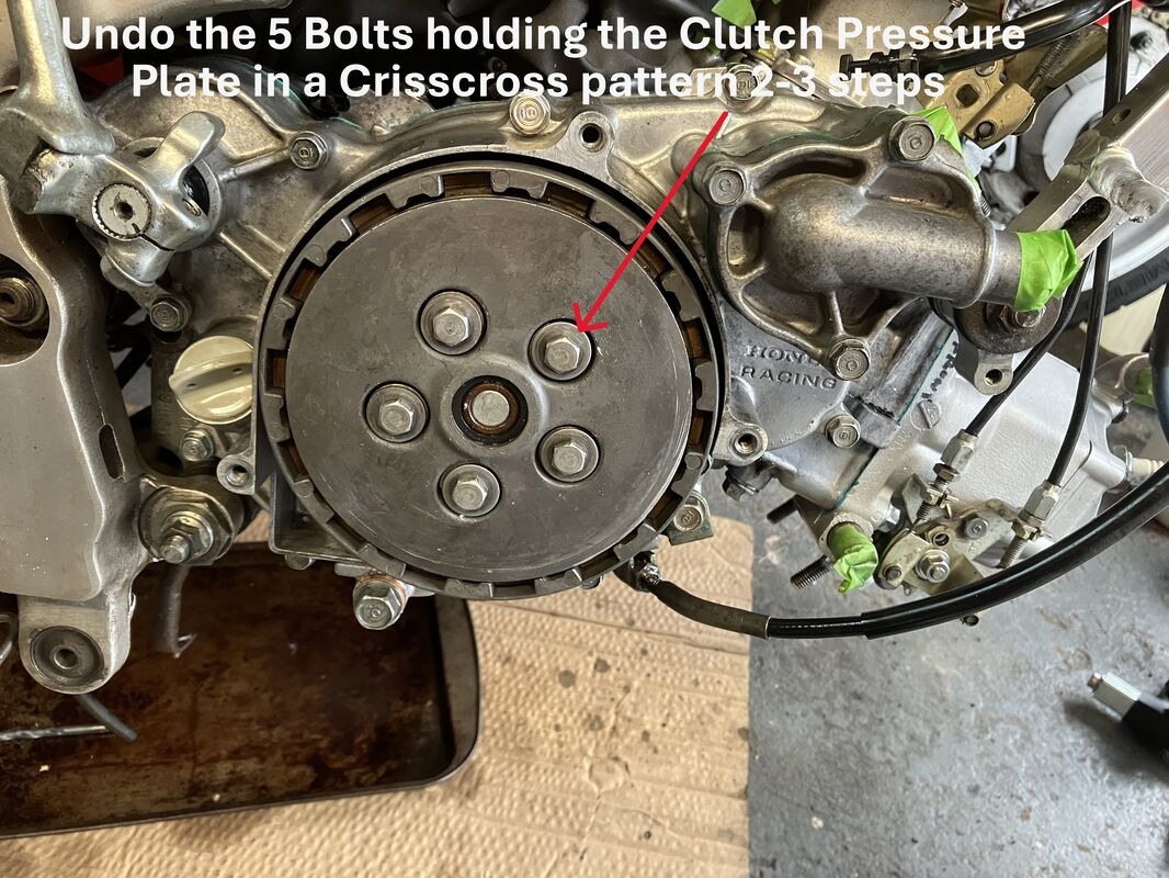

Dry Clutch Removal
Remove of the outer Dry Clutch Cover to reveal the Dry Clutch Pressure Plate.
Undo (in a crisscross pattern 2-3 steps) & remove the 5 Bolts, 5 Clutch Pressure Plate Springs & Pressure Plate to reveal the Lock Nut.
http://nsr250.net/forums/files/img_001725_1_optimized_250_111.jpg
Remove the Clutch Lifter piece (in the centre) & unstake the Lock Nut with a small Screwdriver lightly tapping it with a Hammer, then undo the Lock Nut using an appropriately sized impact Socket & Cordless Impact Driver (the Lock Nut came off fairly easily, which is unusual for me).
The Lock Nut, Thrust Washer, Clutch Plates & Clutch Inner Basket/Drum can now be removed.

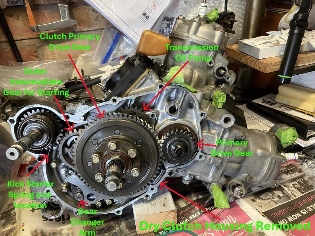

Mon Mar 09, 2026 3:53 pm » Post: #4 » Download Post

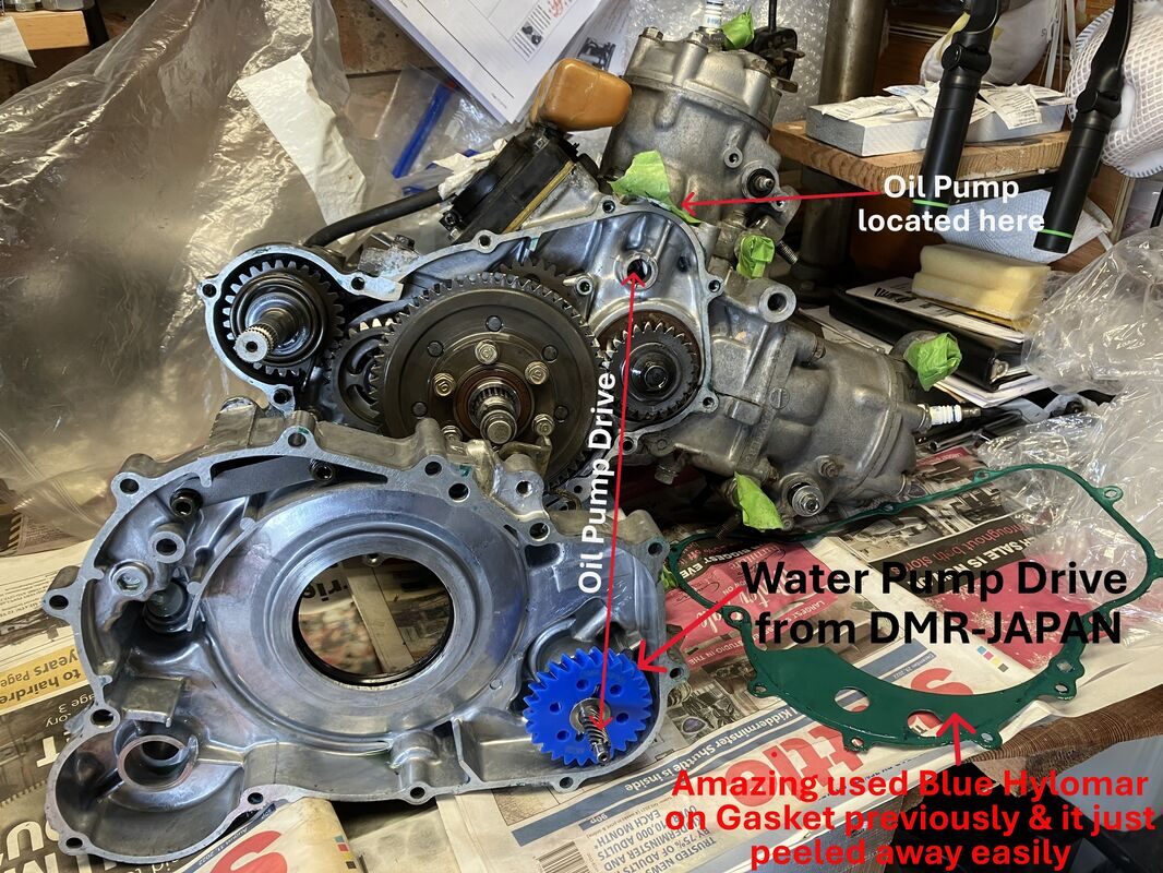

Dry Clutch Housing Removal
Righthand Crankcase Cover Bolts removed revealing the new DMR-JAPAN Water Pump from WEBIKE JAPAN previously installed due to the old Plastic drive gear cracking (not surprising given its age, bit like me really).
http://nsr250.net/forums/files/img_001434_optimized_250_796.jpg
The MC28 Water Pump differs to the MC18/21 regarding the number of teeth on its drive gear, MC28 has 25 teeth and the MC18/21 has 26 teeth so made sure I got the correct pump. The one I chose was Product E4-28005 from WEBIKE JAPAN as it came with the Seals & Gaskets, although it is also available as separates’.
General Components under the Dry Clutch Housing Cover.
http://nsr250.net/forums/files/img_001433_optimized_250_150.jpg

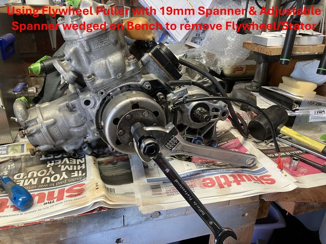

Flywheel Removal
Using a Flywheel Puller tool (TYGA TYTO-0014), 19mm Ring Spanner & Adjustable Spanner the next job was to remove the Flywheel Bolt & Flywheel, which to my surprise came off very easily (have had very bad experiences with Flywheels in the past mostly to do with cars though lol!).
