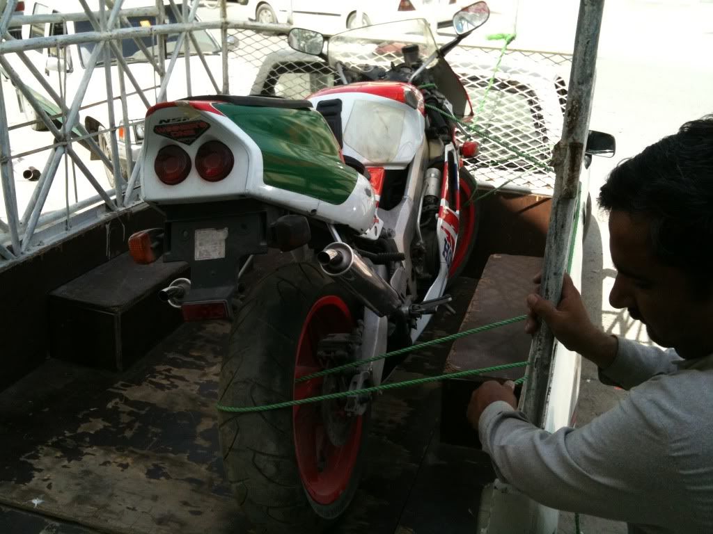

Paid for the bike in full this morning and its on the way here in the back of a truck.
Will fill this thread full of images throughout the day as I start cleaning it up. First one below; Driver 'securing' the bike scrapyard style Laughing

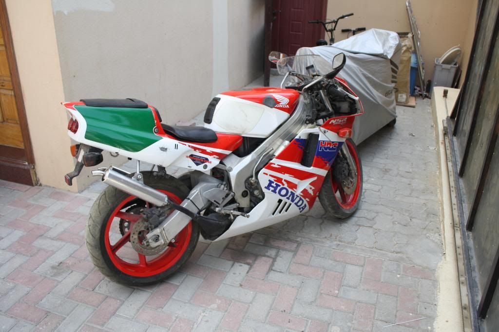

Here we go, lots of pictures Very Happy

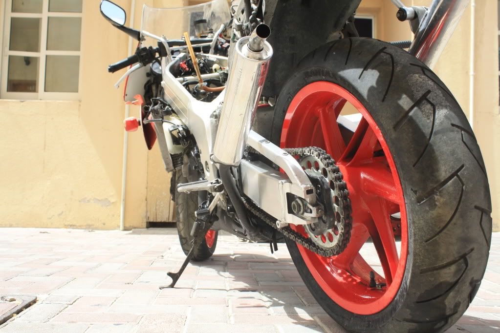

Just arrived home.

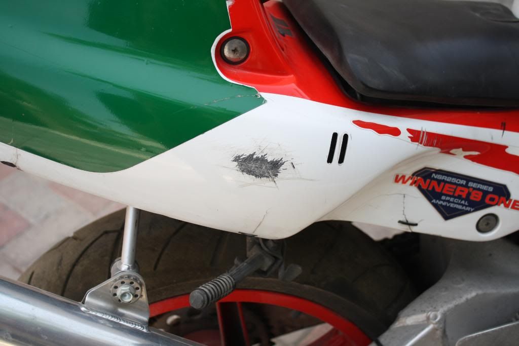

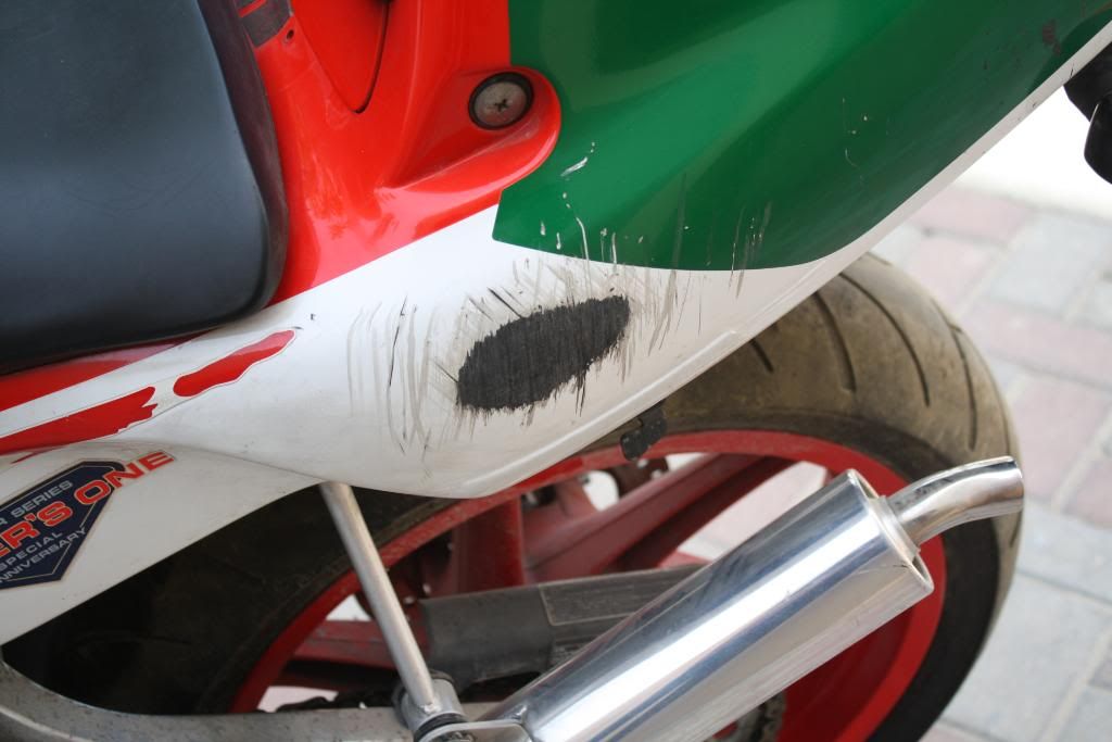

Scrape on rear right panel.

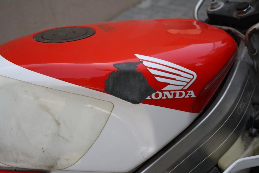

Dent in tank.

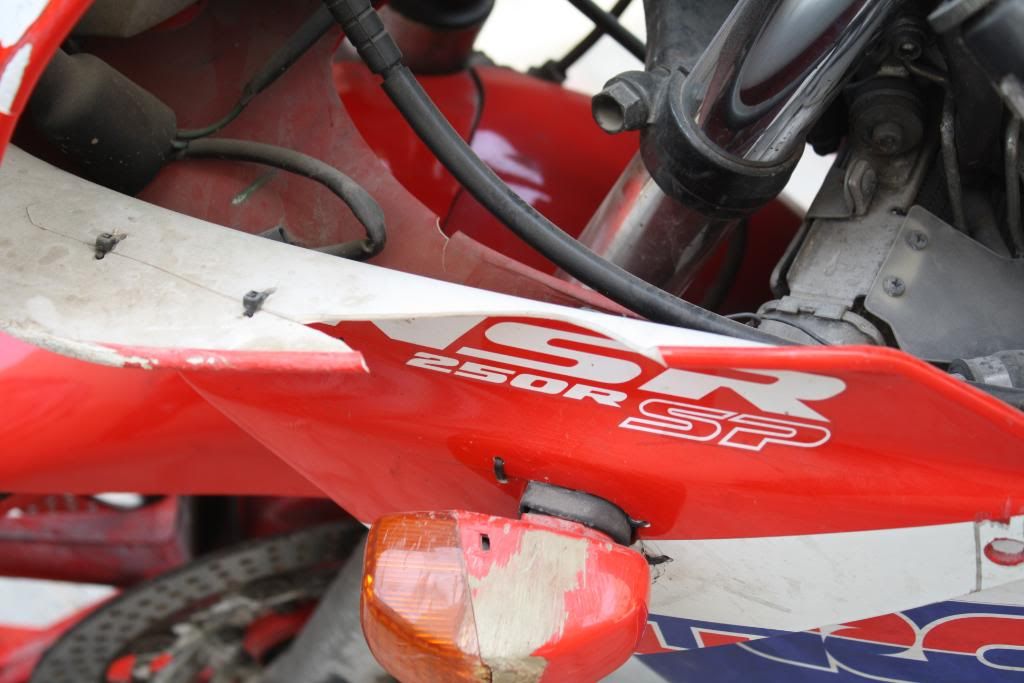

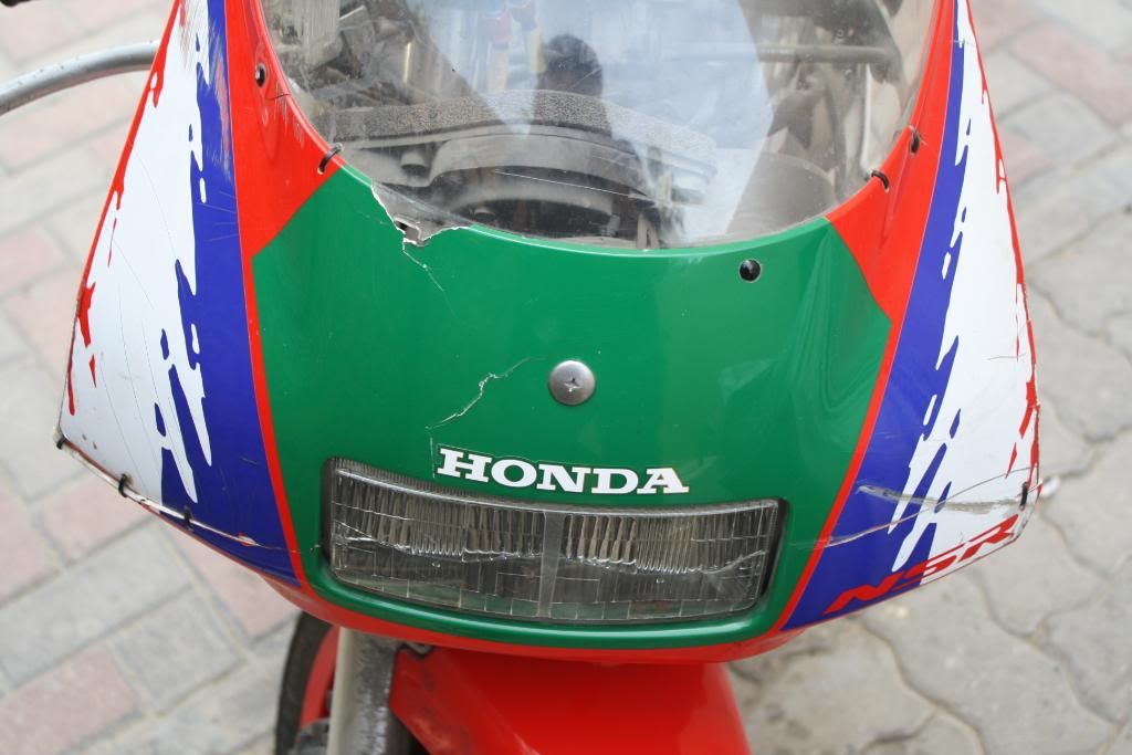

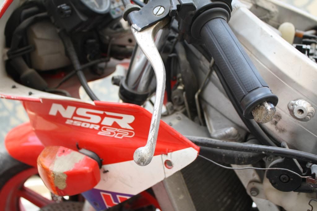

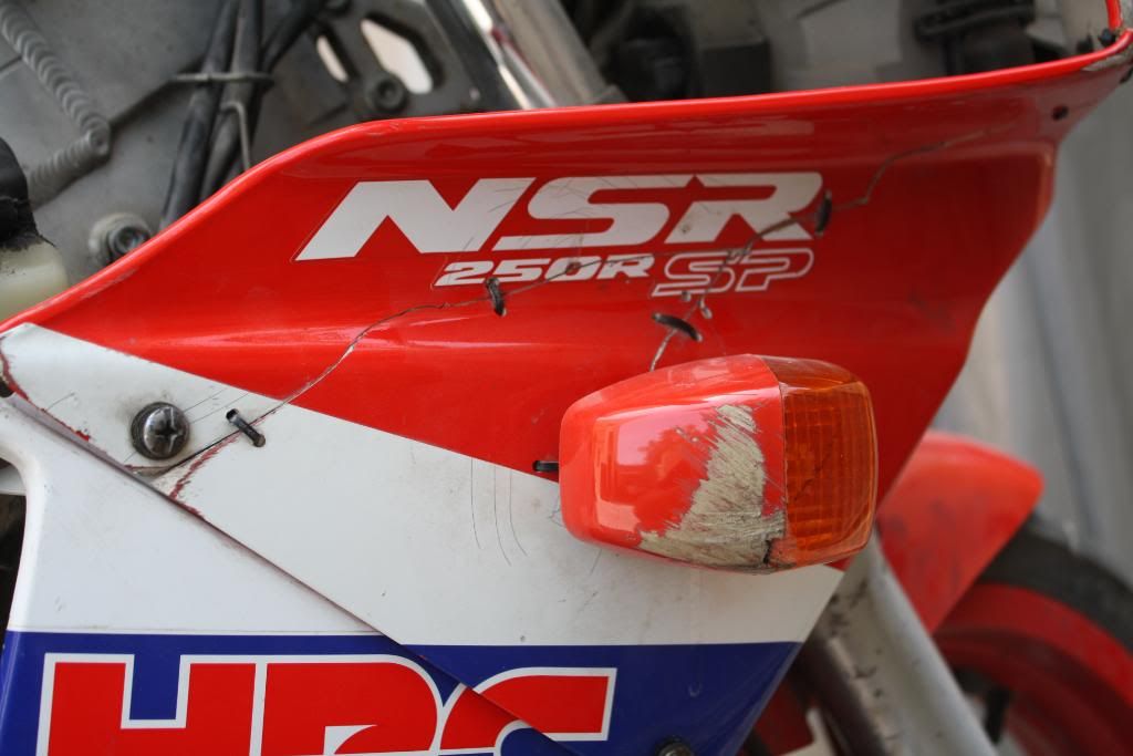

Attempted surgery on front cowl and scrape on right side indicator.
Open cowl surgery...

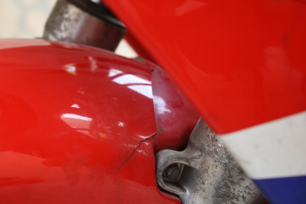

Cracked front fender.

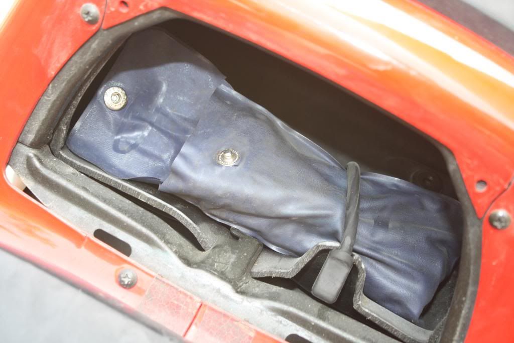

Full tool kit.

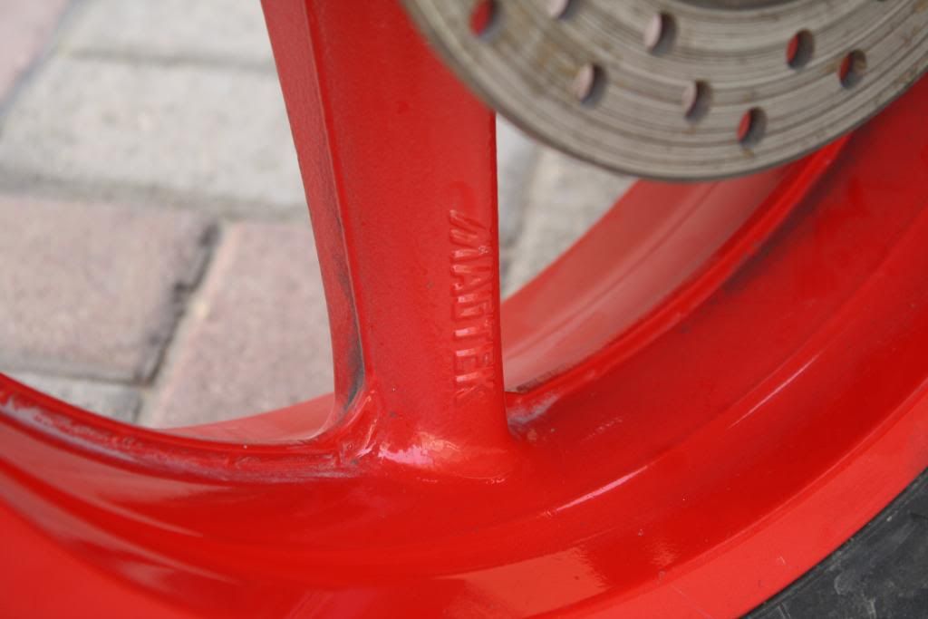

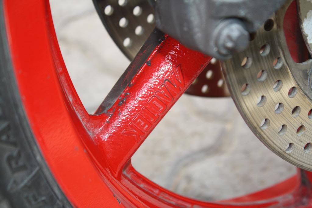

Rear Magtek, dirty but no paint chips.
Front Magtek, dirty, no chips.

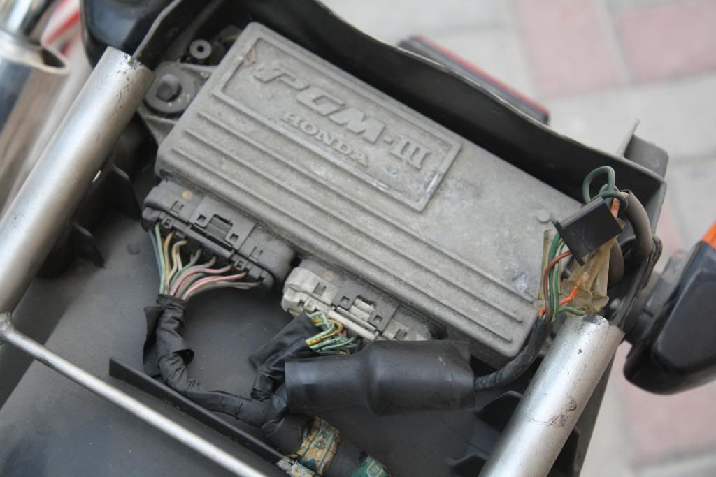

Dusty PGM unit.

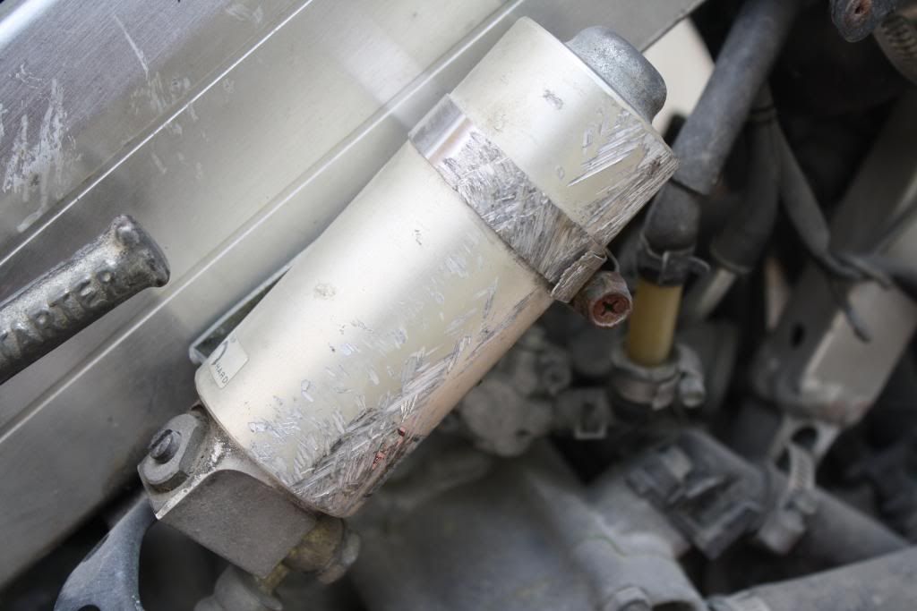

Pretty nasty scratches on rear shock cylinder, should come out with some sand paper.

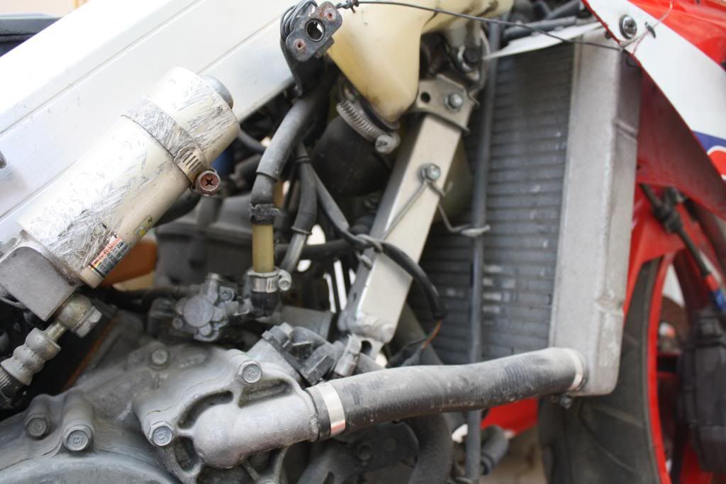

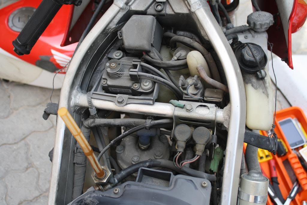

Engine bay, dusty but very tidy.

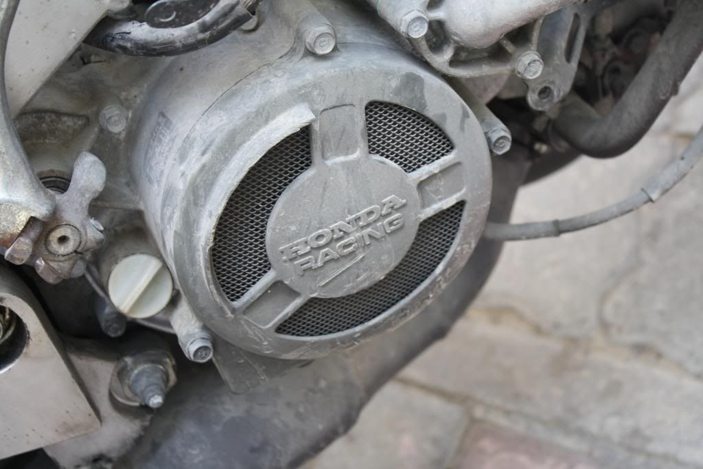

Dry clutch.
General view of right side engine. Oil pump installed, all hose look like new.

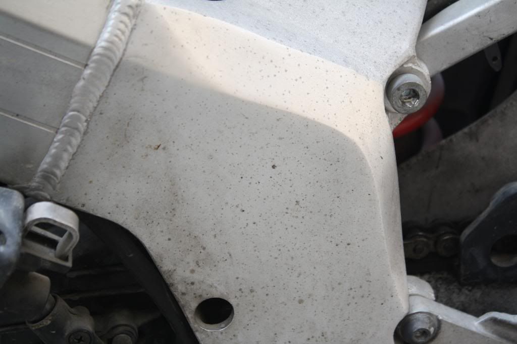

Frame needs a good polish.
Scratched clutch lever and bar end.

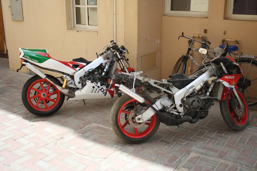

I have the servo motor off the 21 now and I can see why the 28 one failed. This one is in mint condition and I thought the 28 servo had free movement...not compared to this puppy, it's smooth as silk operation. Just about to hook it up on the 28 and see if I get the dreaded ERR2...if I do I'll probably scream a lot, hide the bike and concentrate on gettting the 21 on the road Smile

Unfortunately for the MC28 hater in you the PGM I sent for repair which I originally thought was not repaired so well miraculously revived itself tonight when plugged into an MC21 servo Wink Powervalves are no fully operational...thanks to a MC21 donor lol.

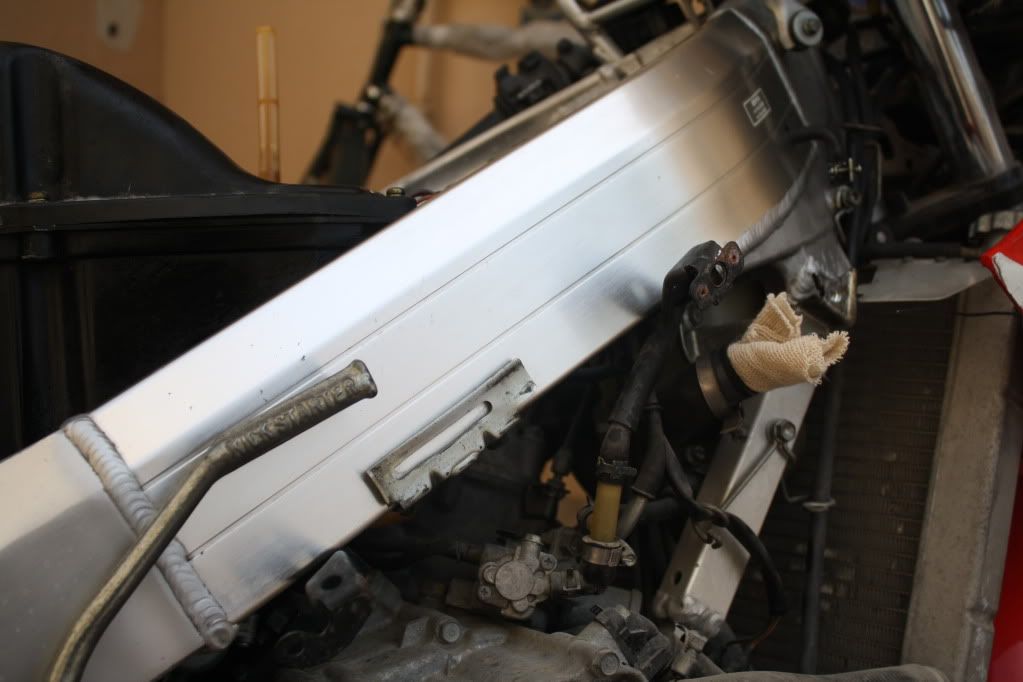

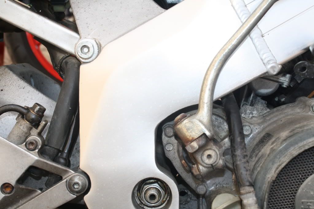

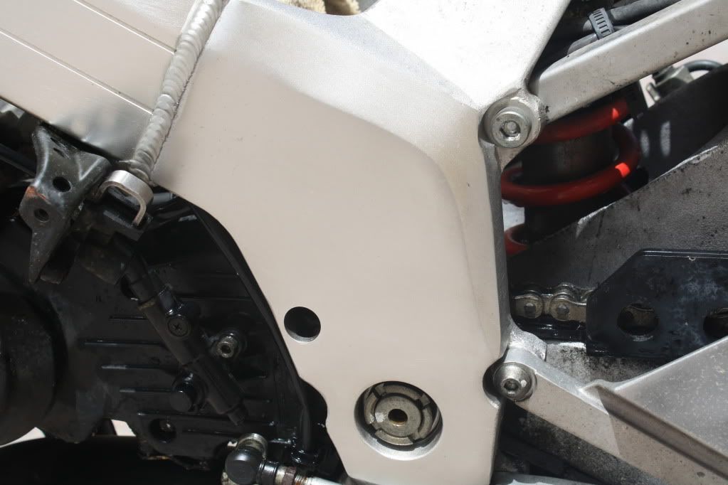

Got the right side of the frame in a better state this afternoon.
Before (this is left side but right side was the same).
After.
Used some wheel cleaner, green side of a wash sponge and a dry cloth and then 220, 400, 600 & 1600 grit paper for the stubborn parts. Could do with a bit more elbow grease but I'll concentrate on finishing it off once the rest of the frame is cleaned.

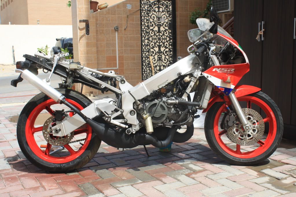

Tue Apr 26, 2011 6:51 am » Post: #15 » Download Post

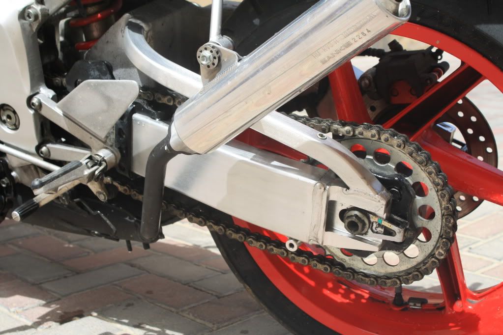

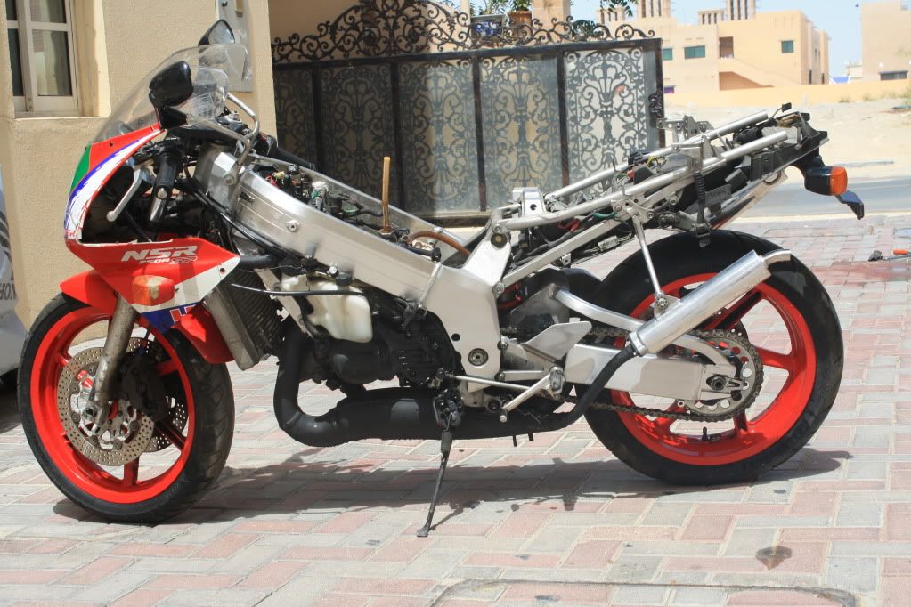

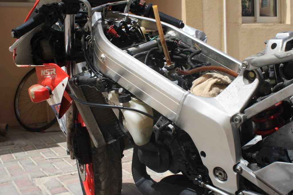

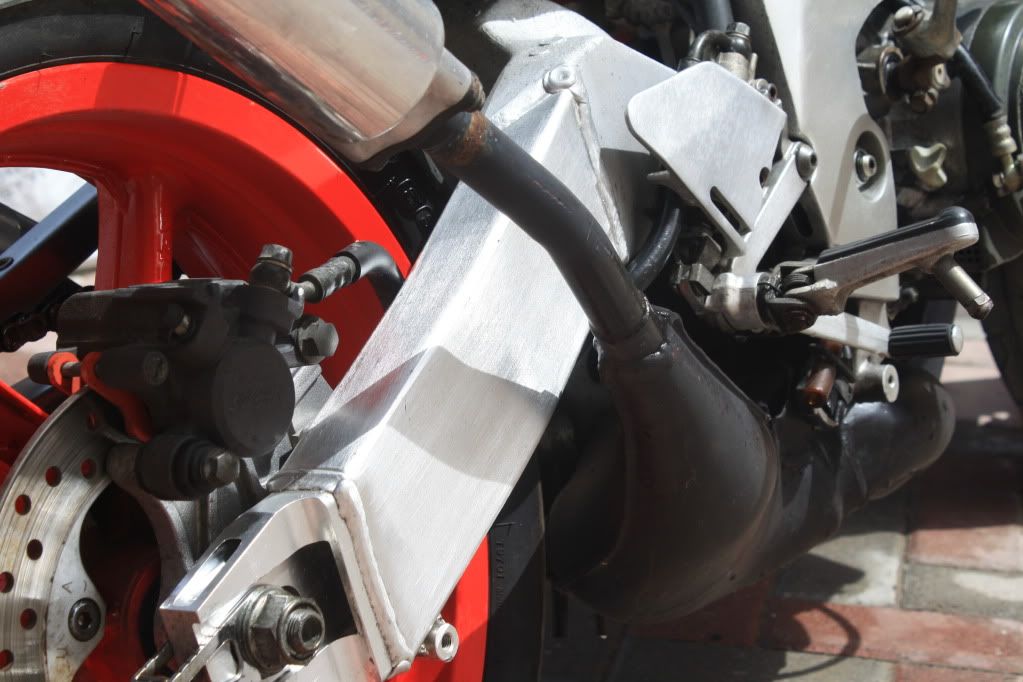

Finished off the frame & swing arm this morning, still needs a final polish with compound but the hard work is done. There are still a few stubborn spots that I need to get the sandpaper on but I'm satisfied with it for now...next is cleaning up the wheels, the most frustrating part of cleaning a bike in my opinion especially when 20 years of dirt has built up!
Anyway, pictures below.
Scrubbed & cleaned entire right side frame & swingarm.
Same with the left side, although haven't cleaned the rearset yet.
The forks have some pretty nasty pitting on them so I'll attempt to clean them up later, should come up quite nicely with sandpaper and scrubbing.
