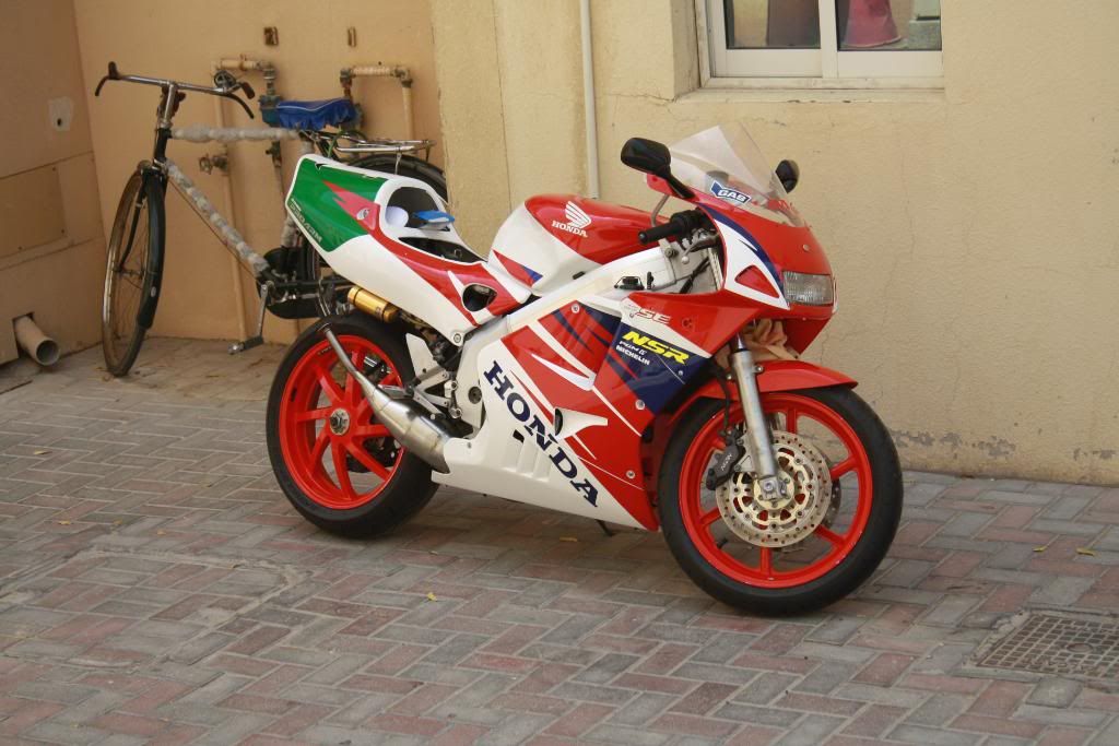

The below image was taken during the first time I saw it, in need of a good clean.

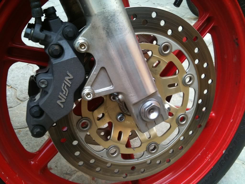

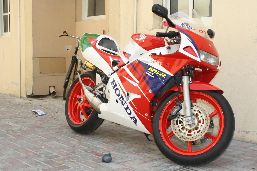

After cleaning the wheels & forks. Stone chips will be touched up or may even get the wheels resprayed.

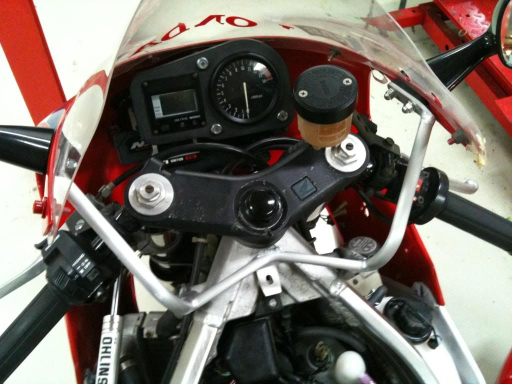

Yoke a bit untidy. Tyga stay arrived last week and yoke nut today.
Silly ill fitting fender. Got the OEM stock one last week and will be installed soon.
After a weekend of cleaning.
Bodywork before I attacked it.
This side was identical until I spent hours cleaning...

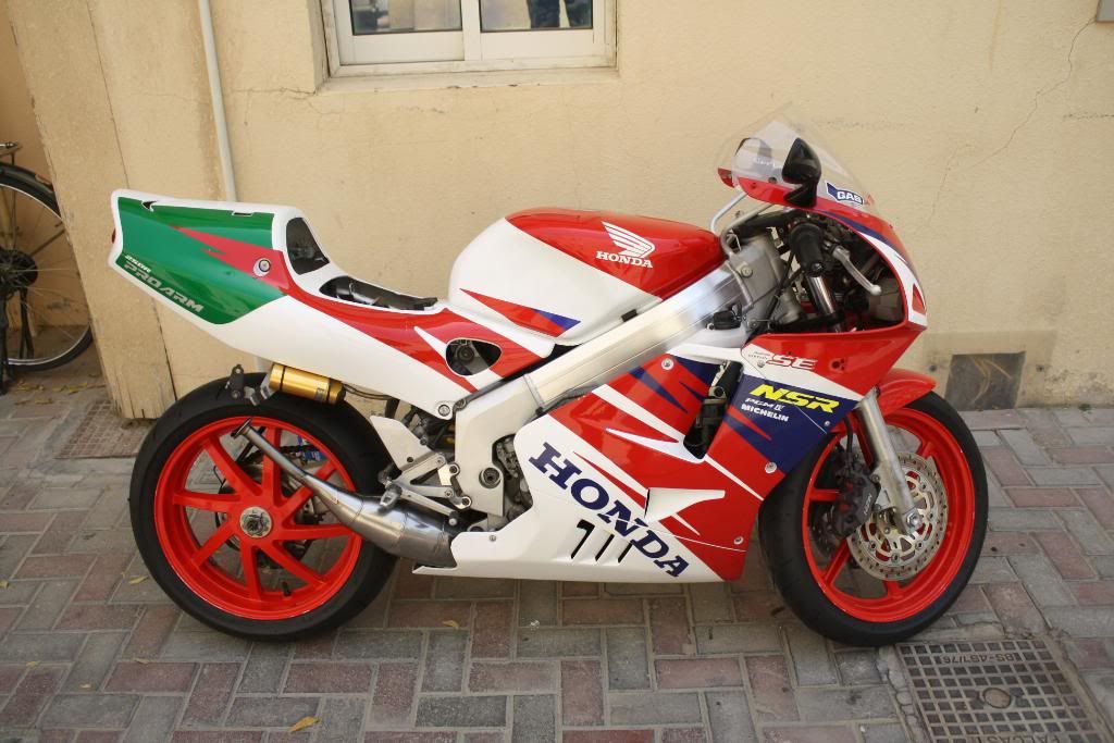

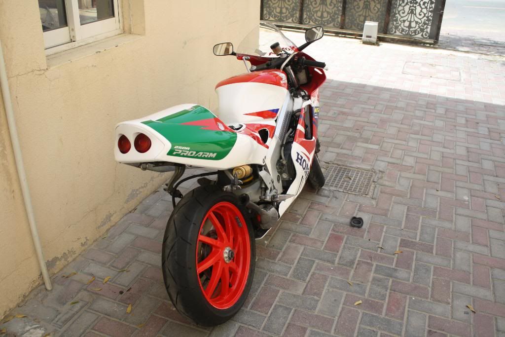

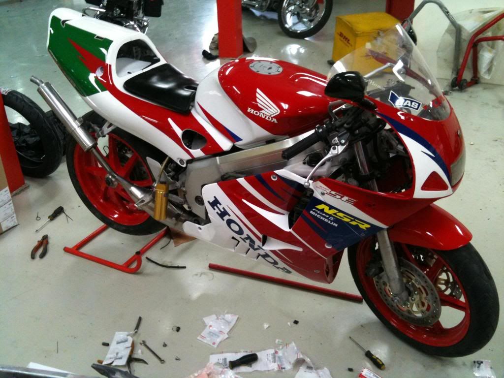

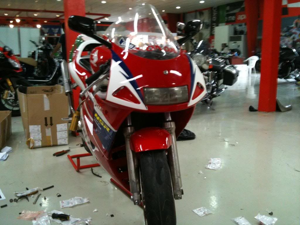

Got the bike resprayed last week so some new pictures below.
New rubber. Bridgestone BT003RS.
Left side.
Front.
Right side.
Rear.
New Tyga bracket installed and new headstock bolt.

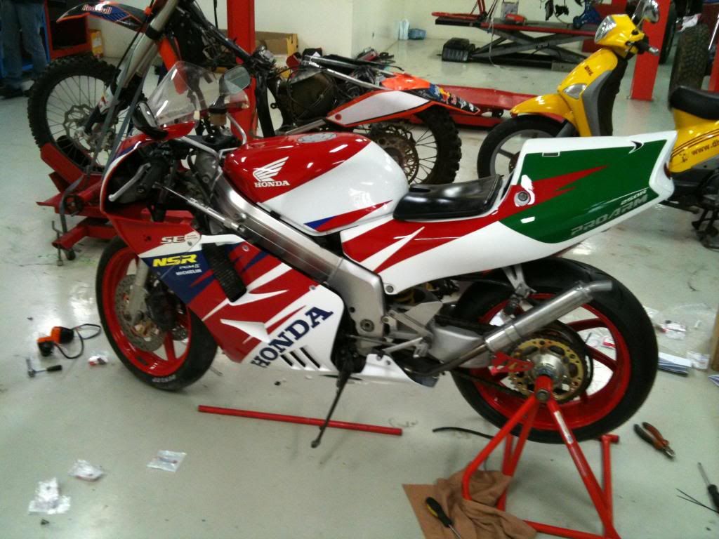

Spent a few hours polishing today as it was perfect outside.
Got the cans off and tried to clean them up a bit but results were not good so placed an order with Mr. HARC for a new set.

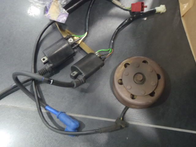

21 flywheel & HRC coils arrived this morning (thanks Dan@Gecko). Need to play around with the coils a bit as the connection is different and I need to do some research on installing the flywheel, anyone have any tips?

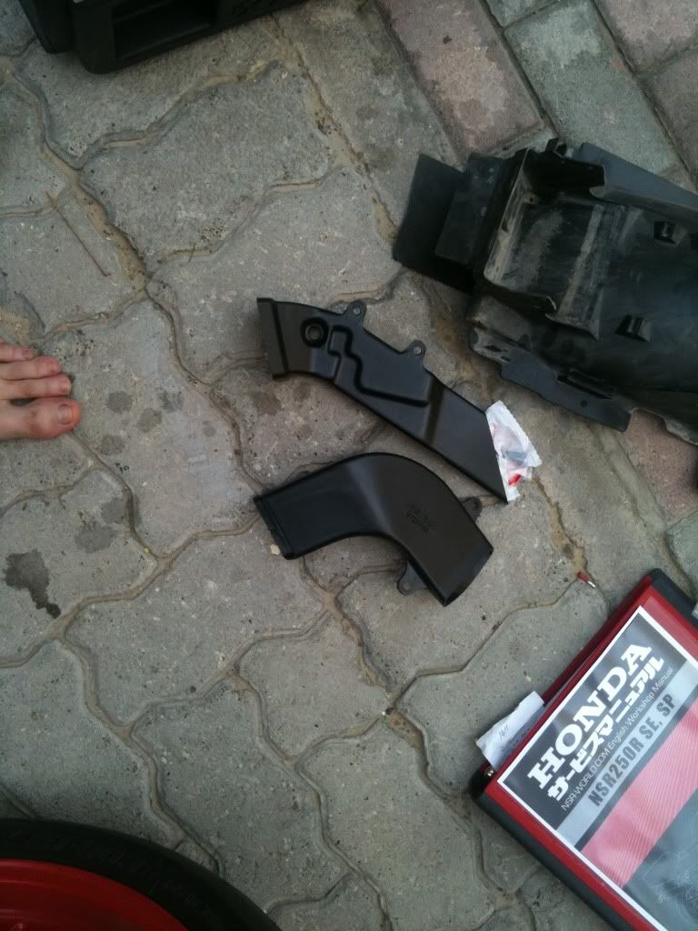

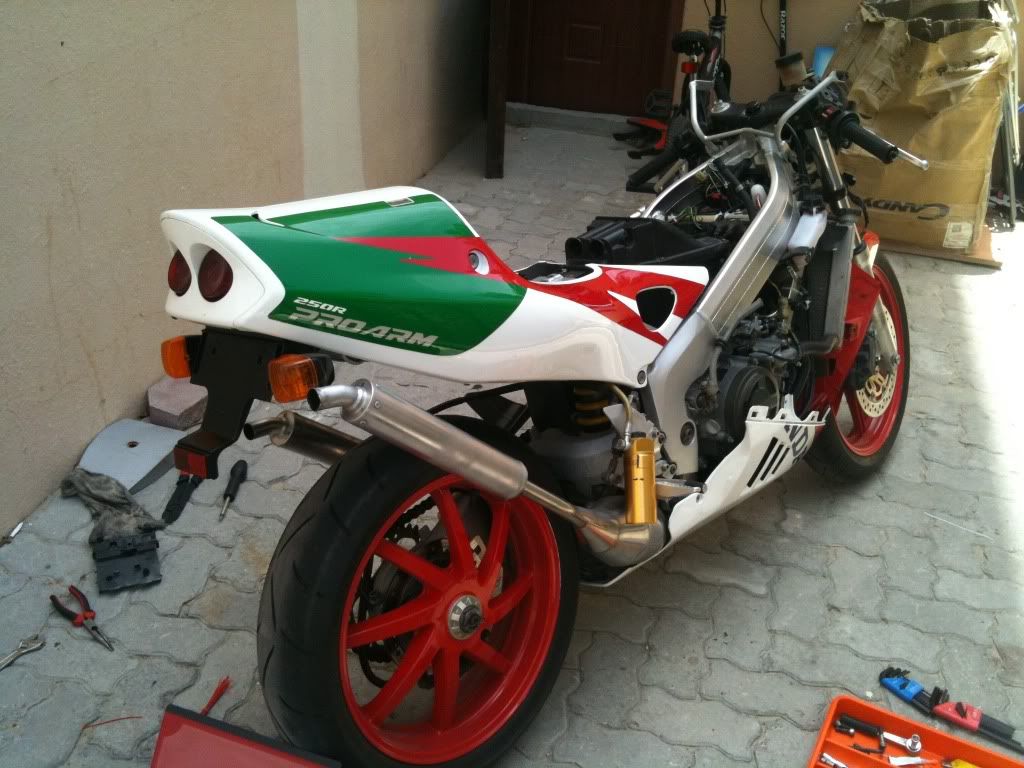

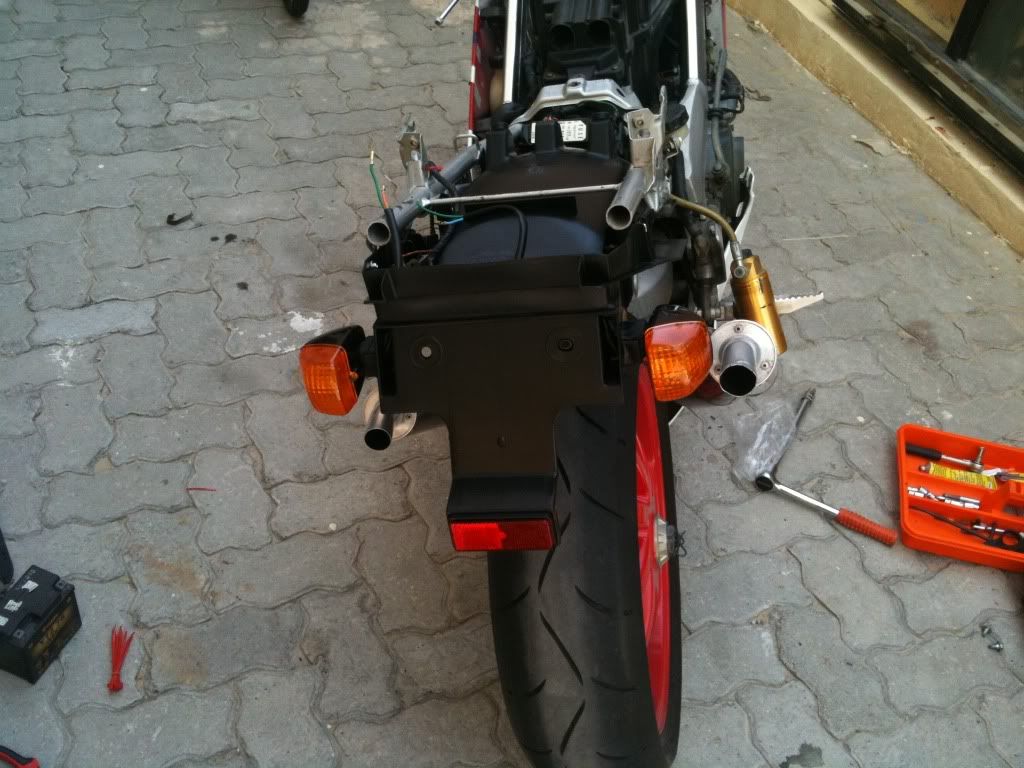

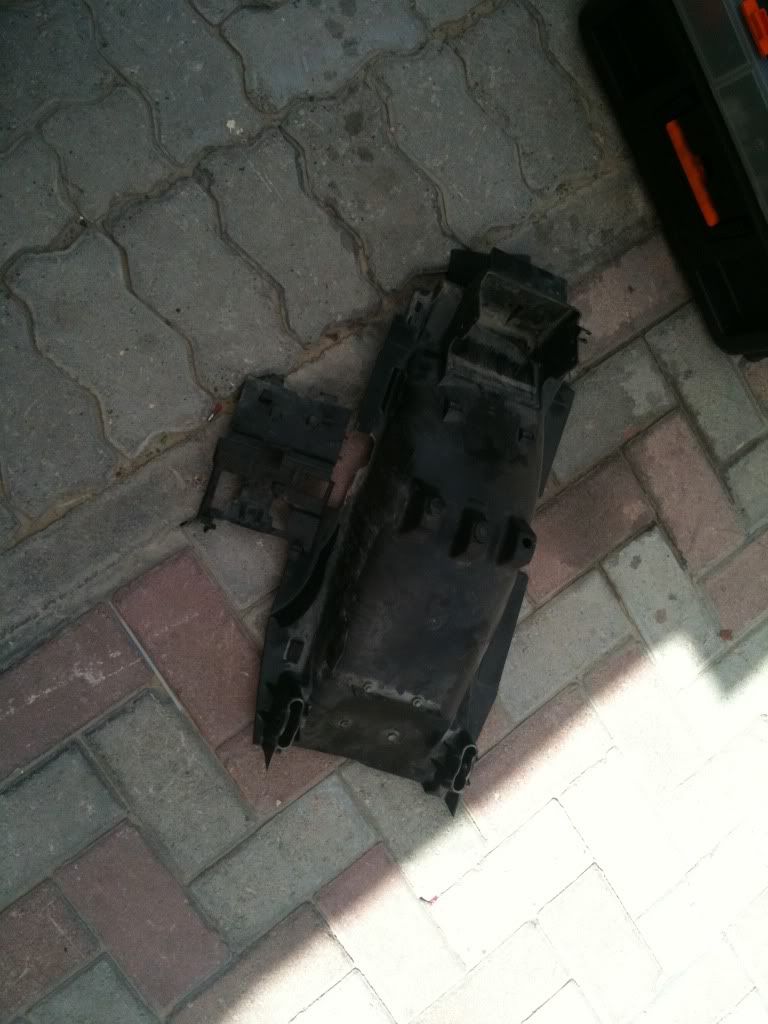

Got the new mudguard installed as the previous owner cut the back of the old one! New & old below, got the new rear indicators and reflector installed too.

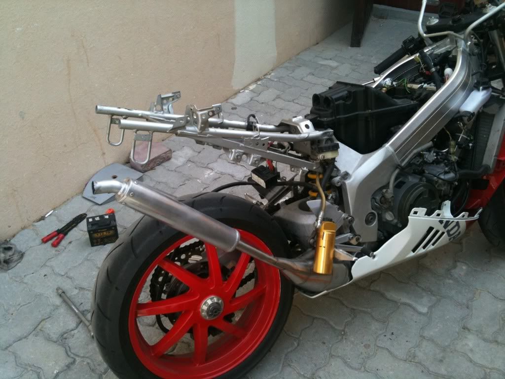

Cleaned up the rear sub frame whilst it was accessible.
Installed a bunch of new bolts on the front brakes.

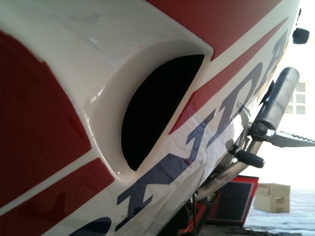

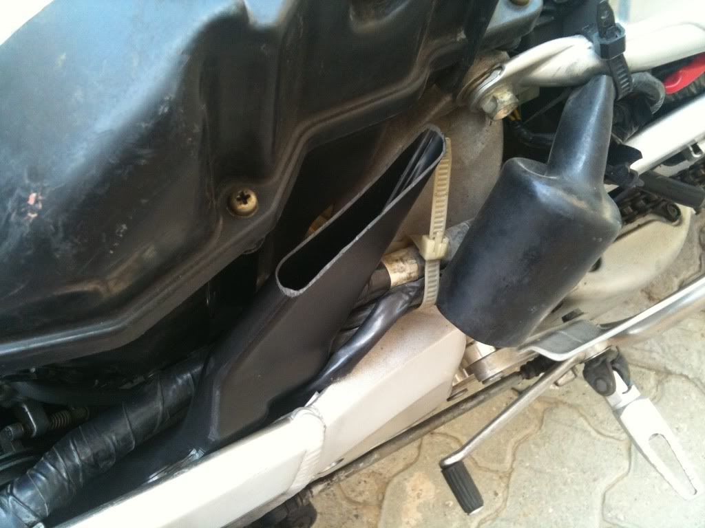

New air duct. Last one was missing but saw it on the parts list and ordered it.

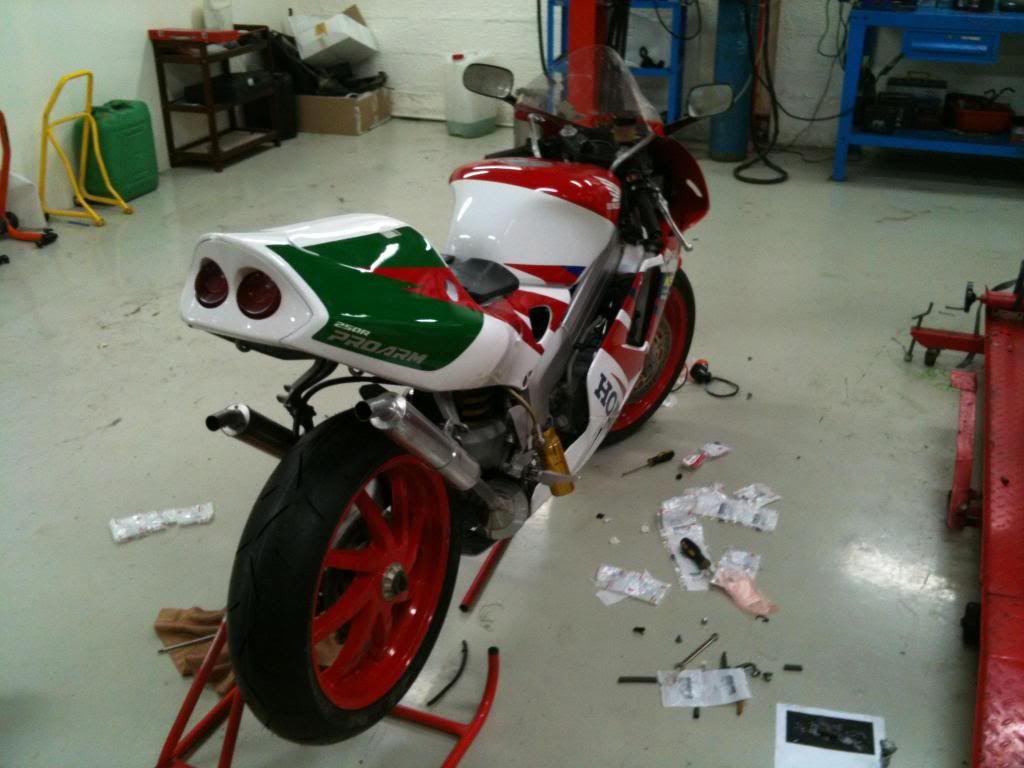

Looking good Smile Ready for registration next week, just hope it passes emissions as the HARC Pro's are probably going to take it of the scale...might have to take some bribery money with me lol.

joeking78 wrote:I need to do some research on installing the flywheel, anyone have any tips?
Undo the bolt in the middle of the flywheel (ideally by using a tool to hold the flywheel still, or, less ideally with an powered ratchet) and use a flywheel puller to remove the flywheel.
Details 2/3rds the way down this page.
