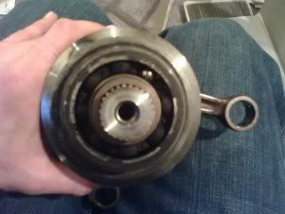

Here is a picture of the crank I just got.
Photobucket
(Ahhhh, the pic phone strikes again Andy!)
You can see that a peice of the ball retainer is missing. Now, there's no way this is usable.... Right ?
This is supposed to be out of a 22KM engine. Is that all these last???
Is it ok to replace just one bearing? The others feel very smooth,tight and are quiet when spun. The bad one has no more play than the others, but does sound dry. So, if I can replace the one, can I take it to the local bike shop? Won't be hard for a pro when just doing an outside bearing..???
And if anyone has one, I'd be intrested in buying it.
Thanks, Steve

I got bloody good (hard) mileage out of mine, but it was totally buggered by the time it was rebuilt! I wasn't missing any parts on mine, but the bearings were well worn.
That bearing MUST be replaced. Get a reputable specialist to do it, no messing. If it costs you $100 more to get someone good to do a single bearing, it could save you ten times that in the long run if it is bodged by the local cowboys!

I had one bad bearing but while I was at it, had both outer bearings replaced by a pro. No problems.
Check the forum for a seller/supplier of bearings
Poul

I had that happen on my 91 KX250, it wasn't even a year old. I noticed it when it started making a whirring noise at certain RPM with no load on the engine.

Its just my opinon but 20K is about average for a NSR crank realistically. No, you can't use that bearing, it must be replaced, and by all counts all three should be replaced as well as the rod bearings. Otherwise your likely to be traing it apart again soon. But that is just my opinion.

Replacing the one outer will be OK, but it you want maximum longevity then it makes sense to do all three.
Although it's not happened to me, that's not the first bearing cage I have seen break up. You just don't know if one of the others is going to go too.
Regardless of what level of work you have done, I would personally never take my crank to anyone that doesn't have (a lot of) previous experience.

That's what I kinda wanted to hear Andy. I'm not looking for the engine to last more than the summer really. I just want to try to get a little track time on the bike to see how I like it. The setup will be stock... So it's not going to be trying to destroy itself. I think I will try to get the one bearing replaced, if it comes apart, oh well.
The guy I will have press the bearing deffinetly knows his stuff. He does everything in his shop, from oil changes to making one off parts. 4 or 2 strokes, street or dirtbikes, old Kawi tripples, exotics, race bikes. He's had em all down there. Just never an NSR. I just don't think I'd want him replacing all the bearings for me... If it's going that far I'd try and source a crank from you cats across the pond.
