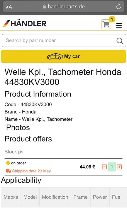

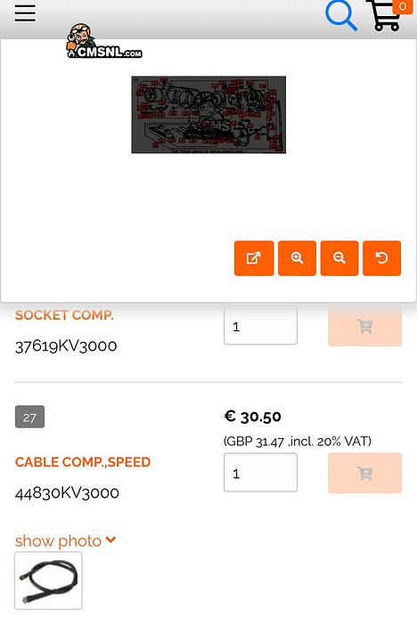

Still after a Speedo cable
Think this is the correct part number
IMG_3759
This any good - they appear to have one
IMG_3758

Fri May 17, 2024 5:04 am » Post: #9 » Download Post
Hello Wayne.
So iīm still looking for the speedo cable, but itīs nowhere to be found for sale.
Tried ordering it from the site, you sent.
But 2 days after, i received an email, telling me, the order was canceled.
Speedo cable out of stock Very Happy

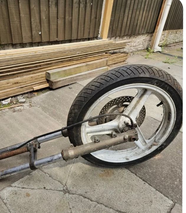

Sun May 19, 2024 6:33 pm » Post: #13 » Download Post
There is a mc16 front and rear end for sale on uk ebay, the front end has a speedo cable attached to it. Maybe the seller will sell you it separately.

Sun May 19, 2024 6:58 pm » Post: #14 » Download Post
Nothing gets past your super hero Spiddie senses
IMG_3832

Tue May 21, 2024 7:26 am » Post: #15 » Download Post
Hey Guys.
Thank you both for the help.
I would love to send the seller a Message, asking for the speedo cable alone.
But in canīt seem to find the ad on ebay.
Even using google lens and the Screenshot wayne sent, i donīt find anything.
Maybe one of you could send me the link.
