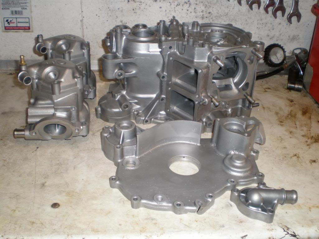

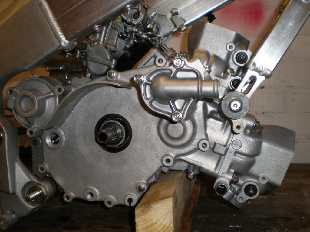

I stripped the engine some time ago so all the bits went for vapour blasting and plating.

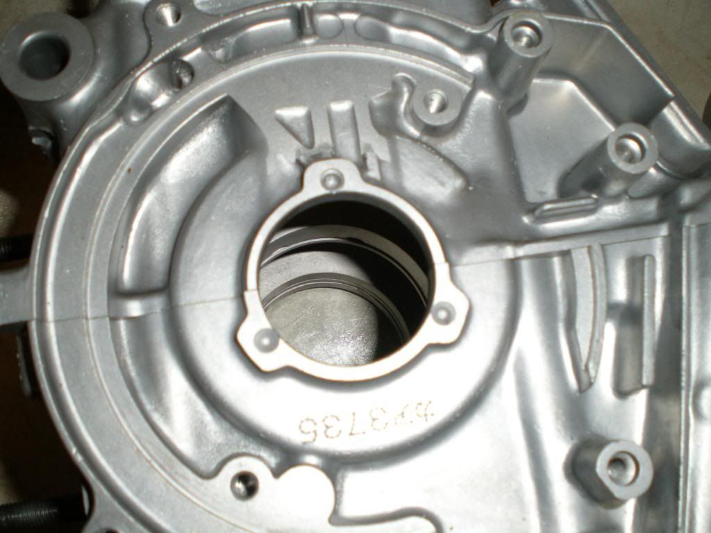

If you read the previous thread on the F3 engine you will see I had a couple of issues to sort out. After a tip from Andy I sourced a set of MC18r2j engine cases from Johnymac. These fit the mc21 chassis and the mc16 crank but needed a bit of machining to accept the F3 ignition.

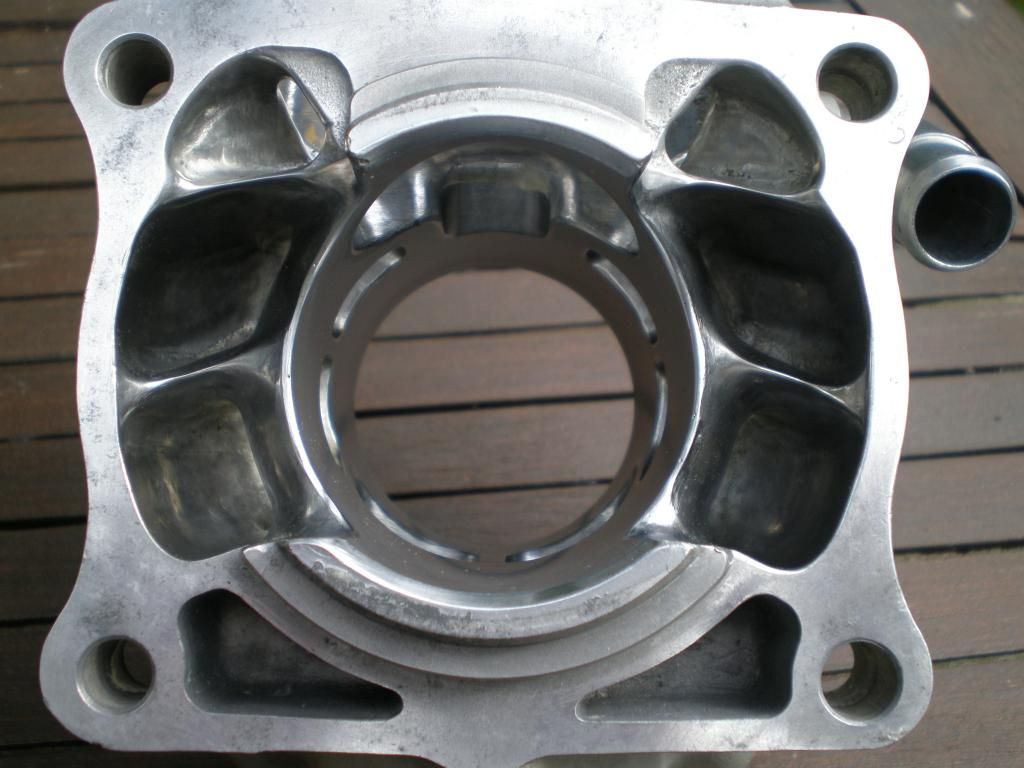

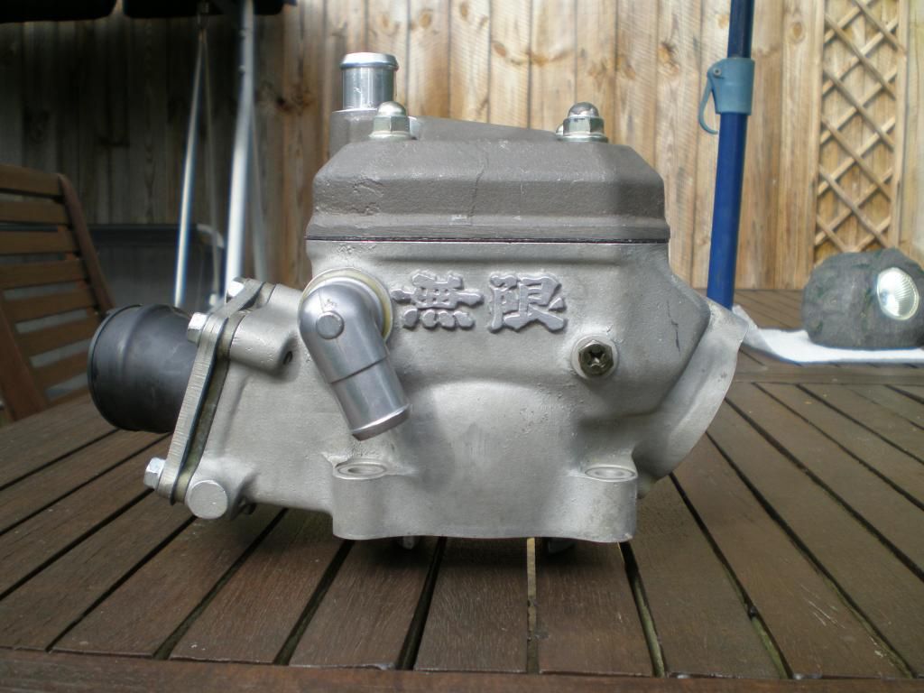

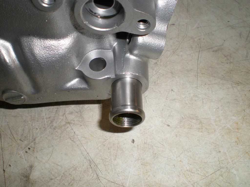

I had the corroded hose spigots on the cylinders replaced with some nice stainless ones.

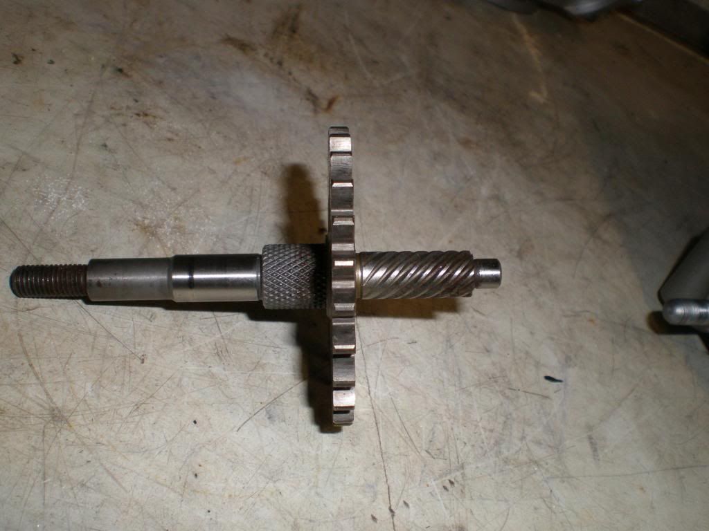

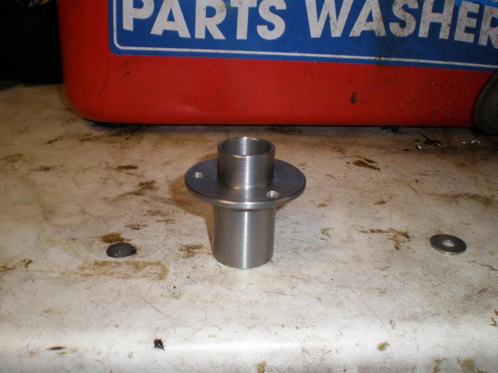

And had an mc21 water pump drive shaft re-ground to accept the mc16f3 drive gear.

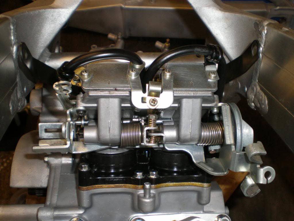

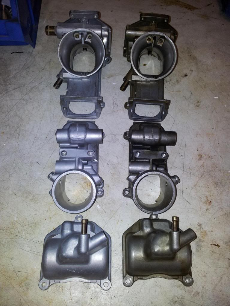

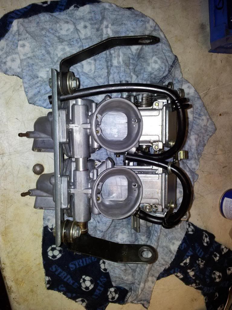

I had a set of mc21 f3 carbs tucked away for a rainy day so I gave these a clean up and rebuild with new seals. I bought one of those cheapo sandblasters from that auction site and used baking soda to blast the carb bodies. Heres a before and after shot.
I thought the result was alright. Gave everything a damn good clean and reassembled with new seals.

Nearly finished rebuilding the engine, just waiting for some bits to come back from the platers. New seals all the way through the engine....well not quite, the R/H main seal is no longer available and the centre seal needs the crank stripping to replace it so I have had to reuse them. Not ideal but i will do a leak check when its all together and fingers crossed it will be okay Shocked
Engine is only a temp fit at the moment so I could measure up for some spacers to be made for the F3 carb supports. Once I get those welded up I can start the build proper.
I have used a mc28 carb manifold to accomodate the 21 carbs which are larger than the 16 ones. The f3 kit deletes the boost bootles and has plugs for the holes in the manifold, mc28 manifolds dont have boost bottle attachments so is a bit of a neater solution.

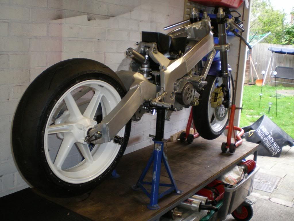

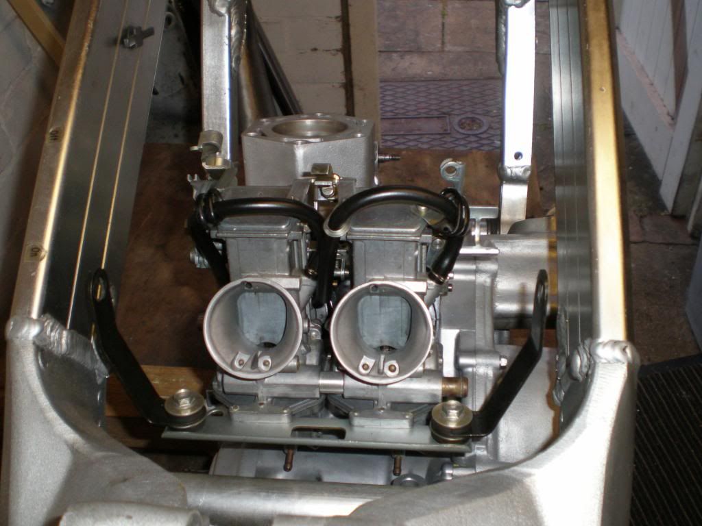

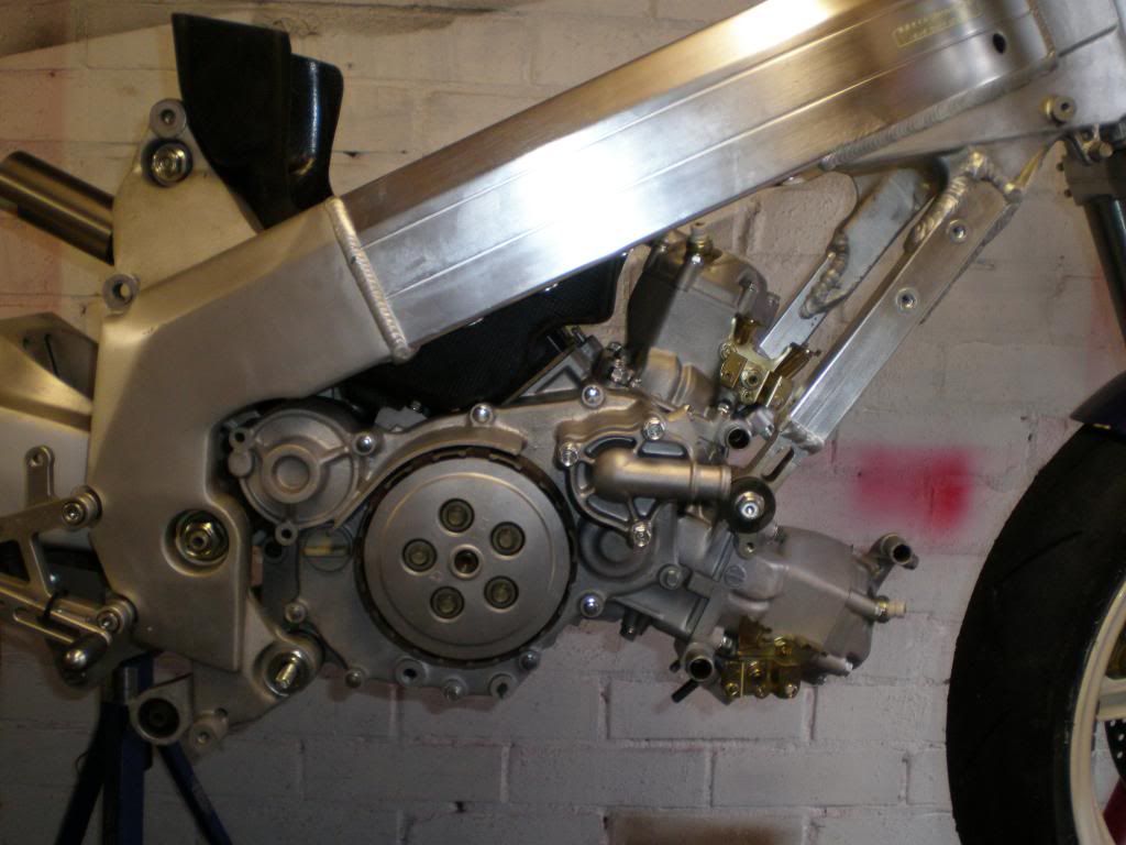

About time I updated this. Dropped the engine out and had the F3 carb support mounts welded to the frame.
Got some nice shiny bits from the plater, finished the engine rebuild, threw the engine back in and installed the f3 carbs and carbon HRC replica air box.
Fitted a set of RS250 NF5 yokes using a Tyga stem conversion, NX5 forks and mudguard, 91/92 NF5 wheels and disks from Yakama, RS125 rear shock and Tyga rear sets.

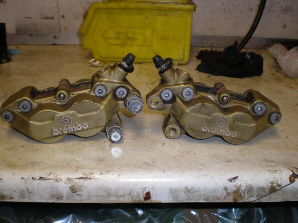

I also scored a set of original fitment HRC RS250 Brembo calipers from Racer38 Very Happy

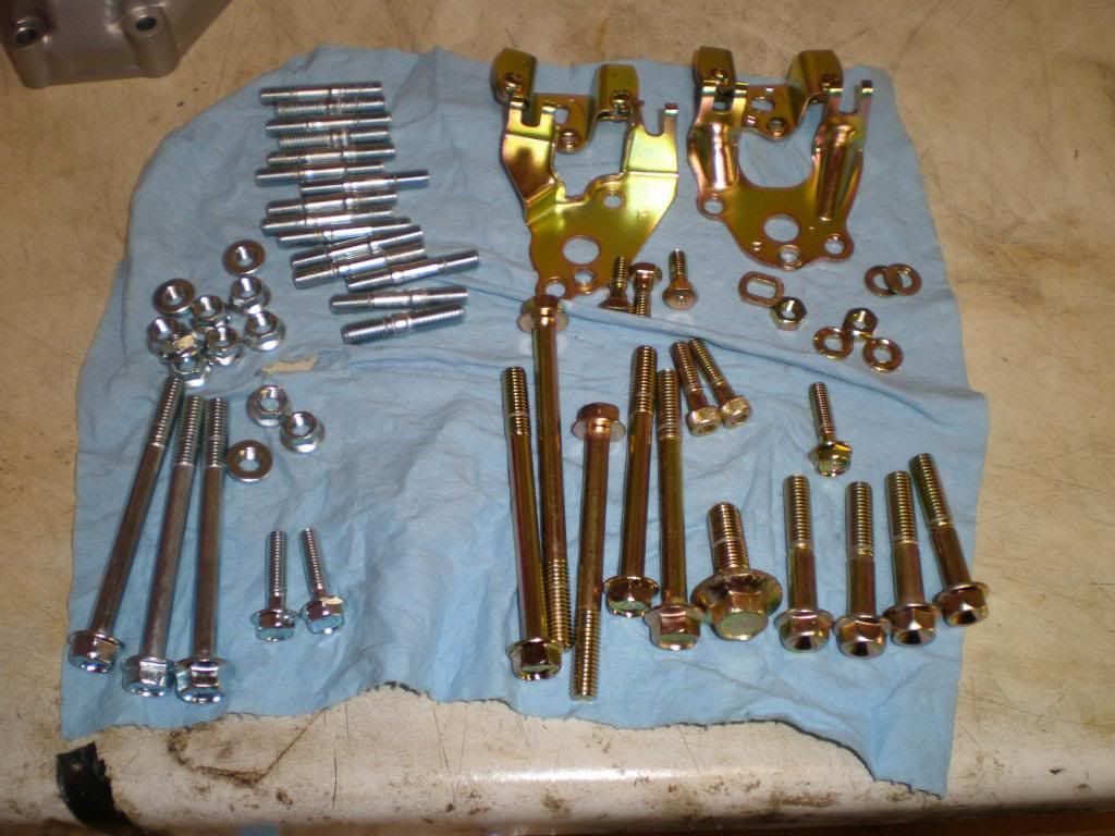

I had a stroke of luck last year when forum member paul nw uk posted an ad in the classified selling a spare centre crank seal, What a result! I dropped and striped the engine for about the third (and probably not the last) time and the crank is away having the new seal and main bearings installed.

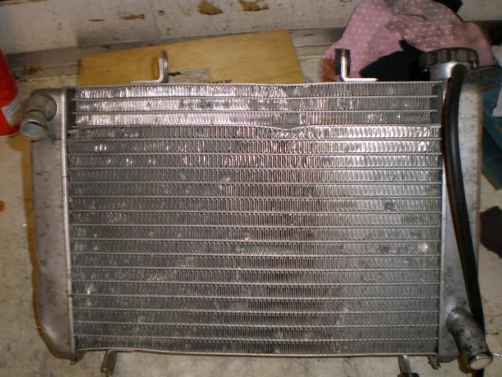

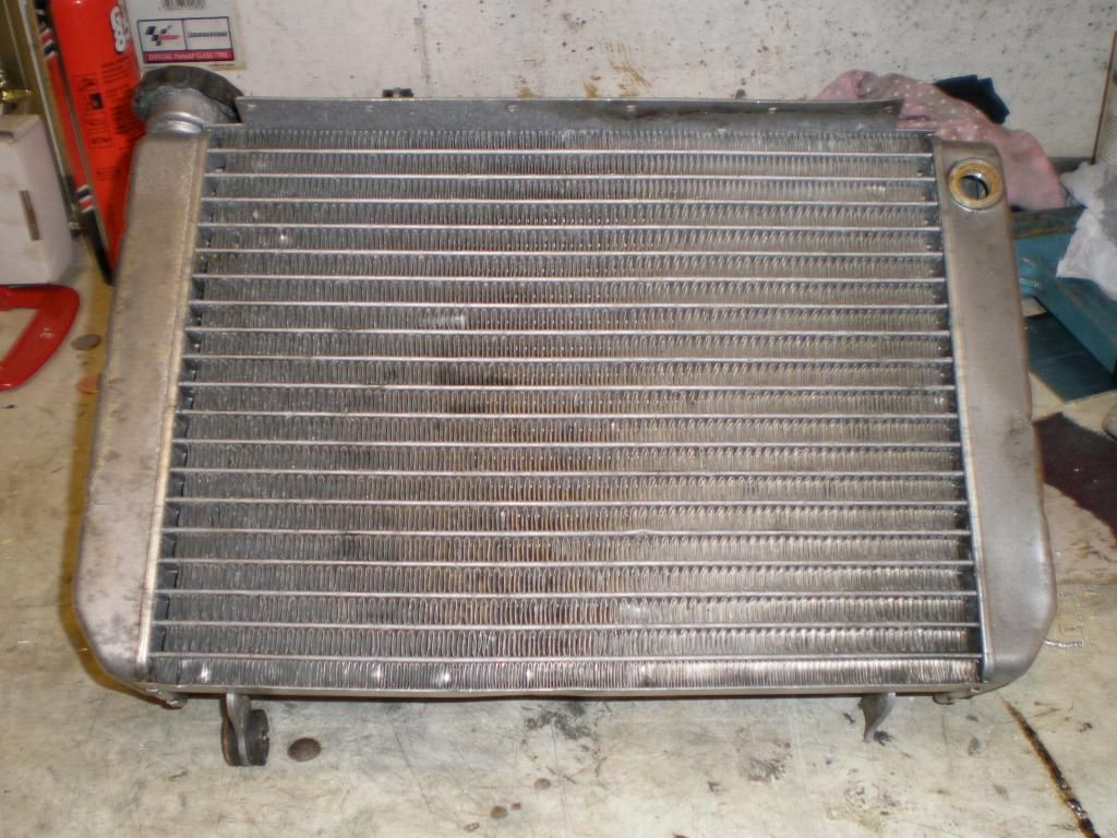

The other good result I had last year was finding a HRC MC18 F3 radiator with HRC temp gauge and RS125 rear brake on Yahoo Japan, a quick email to Moriwaki man and the parts where bought and posted to the UK. Excellent service again from Drew!
Unfotunately it does have a dented header tank on one side, its not to drastic but another job on the "to do" list! It also needs the two upper mounting lugs relocating to suit the 21 frame and a broken lower support lug replacing.

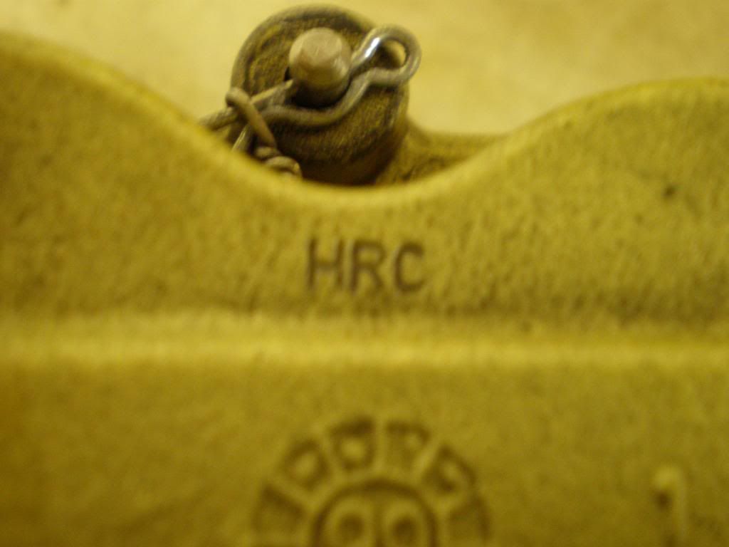

I also had this piece of non NSR 2 stroke filth arrive in the same package from Drew Very Happy

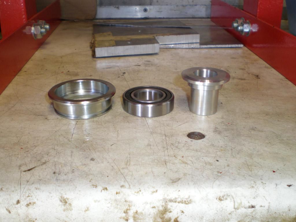

I mentioned in an earlier post I sourced a pair of 92 RS250 NF5 wheels from Yakama, these of course arent a straight bolt on although they use the same spindle size so not a total nightmare. Big thanks to Tom aka racer38 who kindly lent me a NF5 rear sprocket carrier/left hand wheel spacer which I had a friend copy for me.
With this spacer installed The front/rear sprocket alignment is spot on so I have measured up the right hand spacer which also carries the RS125 brake caliper carrier. I'm waiting on this and a bunch of other parts which are in the process of being machined and will complete the F3 style rear brake set up. Another top tip from racer38 was The shiny brand new rear disc, this is an ATC250 rear disc which is the exact size and bolt pattern of the no longer available NF5 disc. The rear caliper has been blasted painted and rebuilt with new seals.

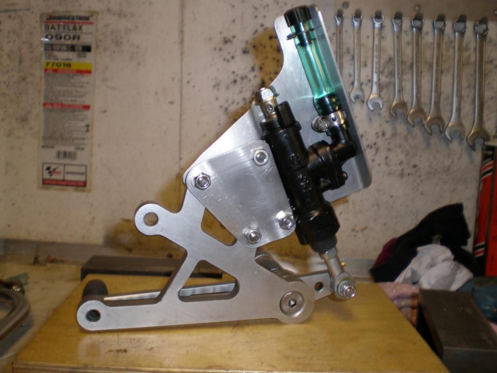

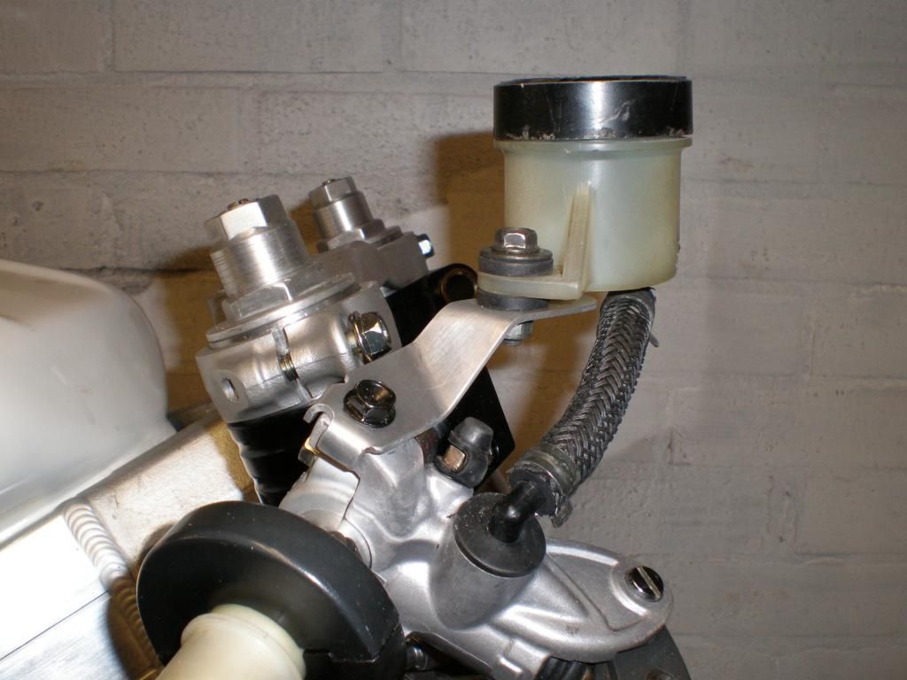

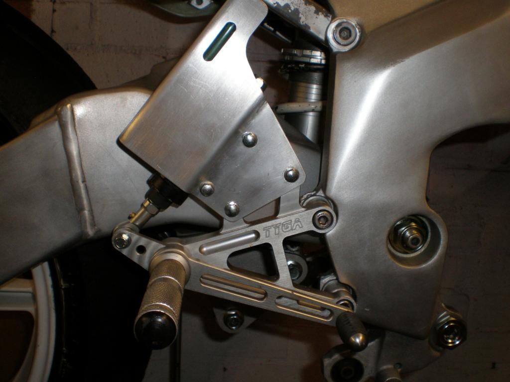

I have also stripped, blasted, painted and rebuilt the RS125 rear master cylinder. I didnt like the way it mounted on the Tyga rear sets, so I fabricated a spacer/heel plate/guard type thing to reposition it.
I'm not 100% sure if I like the way it looks so I might redo this at a later date.

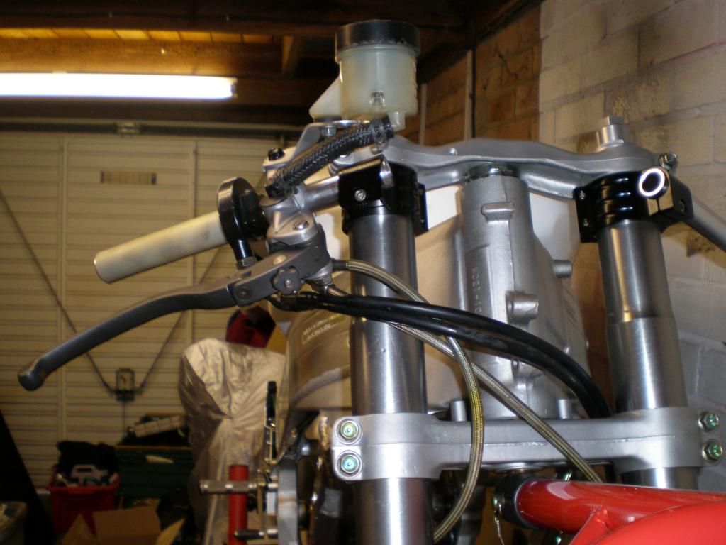

I bought a Nissin radial front master cylinder from Watfordhorn, this was a tacky bronze fake magnesium finish, I personally feel that sort of thing is best left to gixxer owners and has no place on an NSR so I stripped and soda blasted it back to a more tastefull natural finish Very Happy
The fluid reservoir is a standard NSR part, the hose is a new RS125 part and the reservoir bracket was fabricated by myself. The Goodrich hoses were on my mc21 before I replaced them with a set of HEL's.

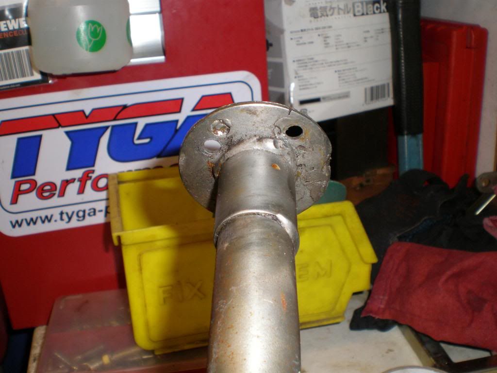

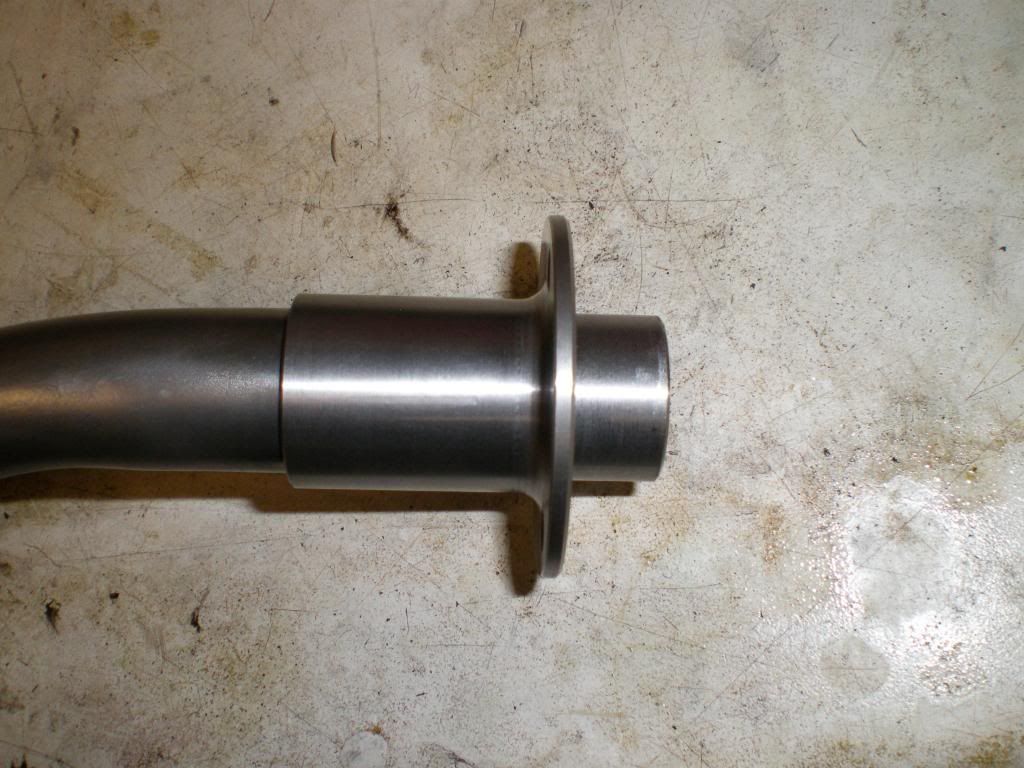

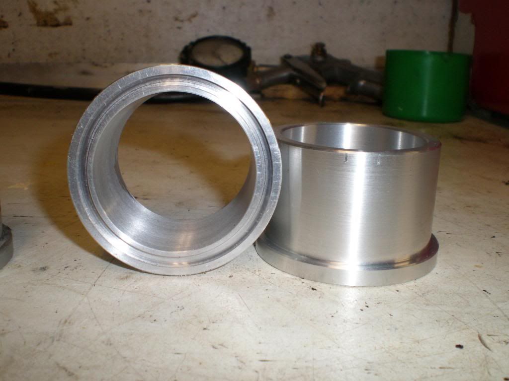

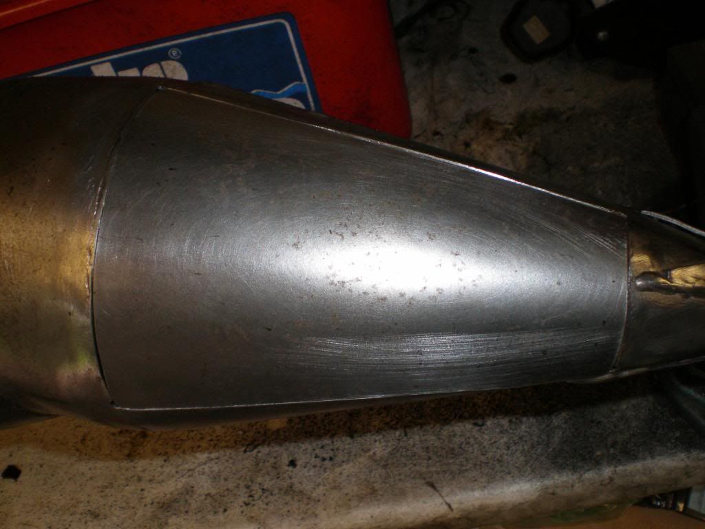

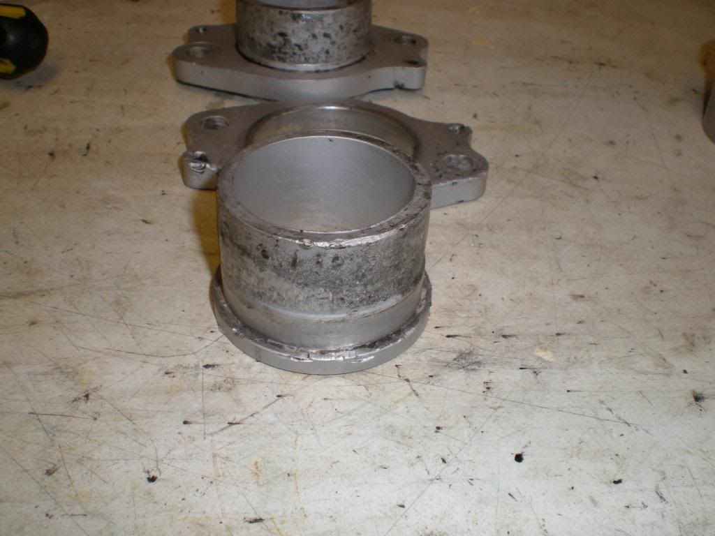

I plan to use a set of Dogfight exhausts which have been kicking around my garage for years. They are a little bit used so need some repairs, the first issue being the worn manifolds which rattle around in the exhausts like a P**** in a bucket!
Had these nice shiny tight fitting new ones machined up with o-ring grooves.
Issue number two is the silencer mounting flanges which had been drilled and redrilled to accept various silencers with different hole mounting patterns. I ground these off and have had a pair machined to suit Tyga silencers, these are cheap and readily available as I will crash this bike at some point Shocked
Issue number three is the standard dent to the right hand exhaust.
I cut out the damaged area and formed a replacement section.
These are now away being welded.
