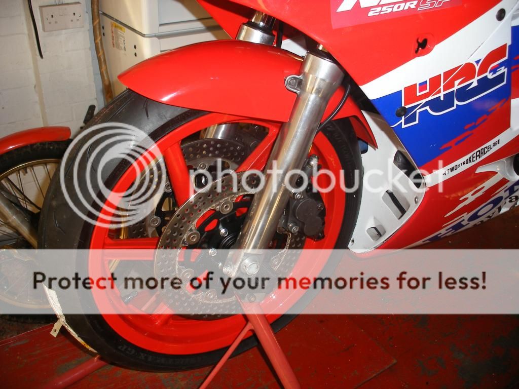

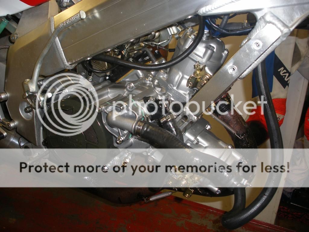

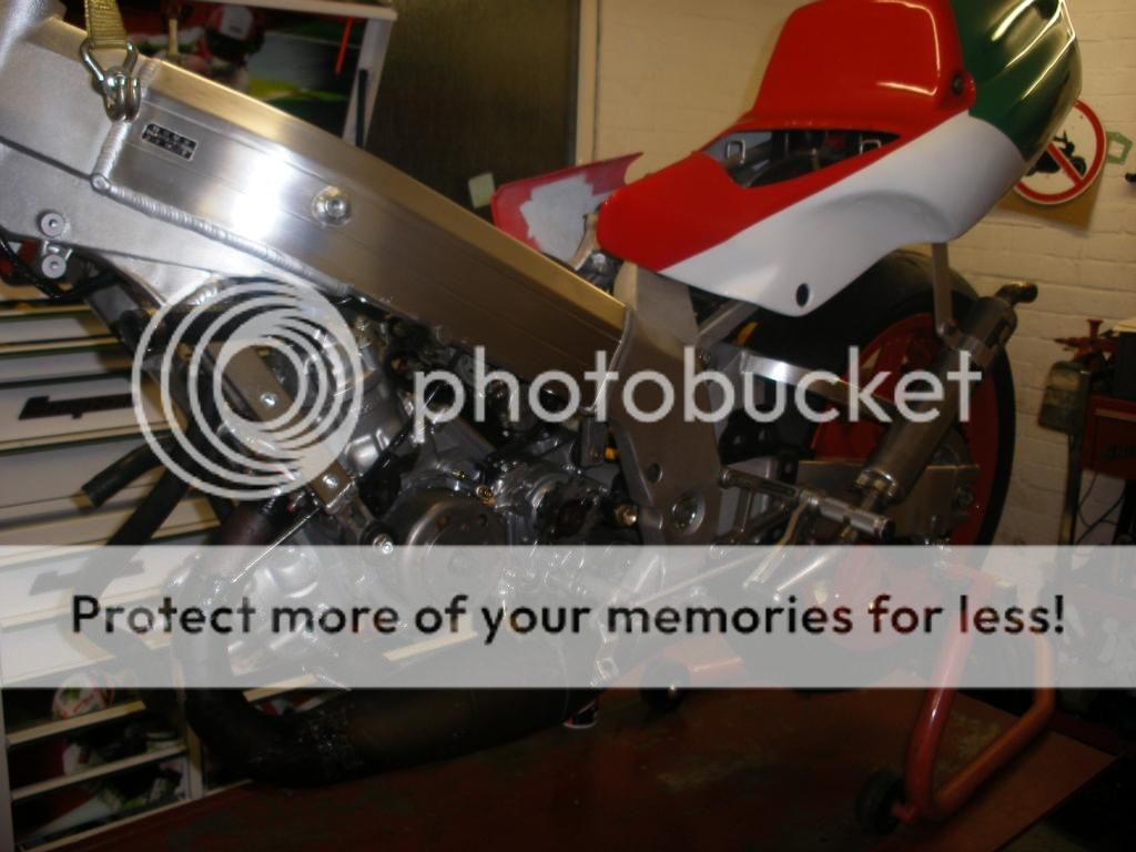

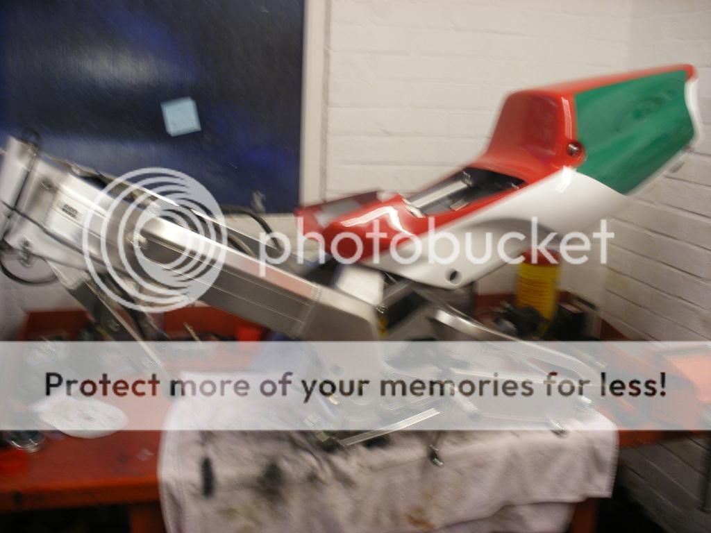

Hi everyone
Got myself a new project it almost uses all my spares for 21 that I have,
Went up to Ashbourne in Derby last sat and bought a frame and swingarm from a very civil guy who has just imported a few bikes from Japan {with nova cert} it was very clean and straight under the grime and as soon as I got it home I jizererd it scrubbed it and gave it a good steamclean, very presentable frame,
with help from Tom Racer 38 who had a pr of 21 crankcases I could then get on and build the motor,It has HRC f3 gear kit and clutch, rebuilt crankshaft,new pistons and rings,all new gbox bearings,HRC jetted carbs,Hrc loom and deristrictor,rear head conversion,JHA exhaust,CBR 600 rear shock 21 sp forks,rs 250 bottom yoke,polished 28 top
Tyga rearsets, White power damper,refurbed Magteks and new 209 gp controlled tyres,just waiting for a rad,pgm,and ign pickups to arrive from Japan and with a bit of luck it should be running this week,
sorry about the first crap pic,
vv photo DSCF4340_zps2897b056.jpgv

Ooh that's a sweet looker!
Rather long springs for the exhaust chambers though?
