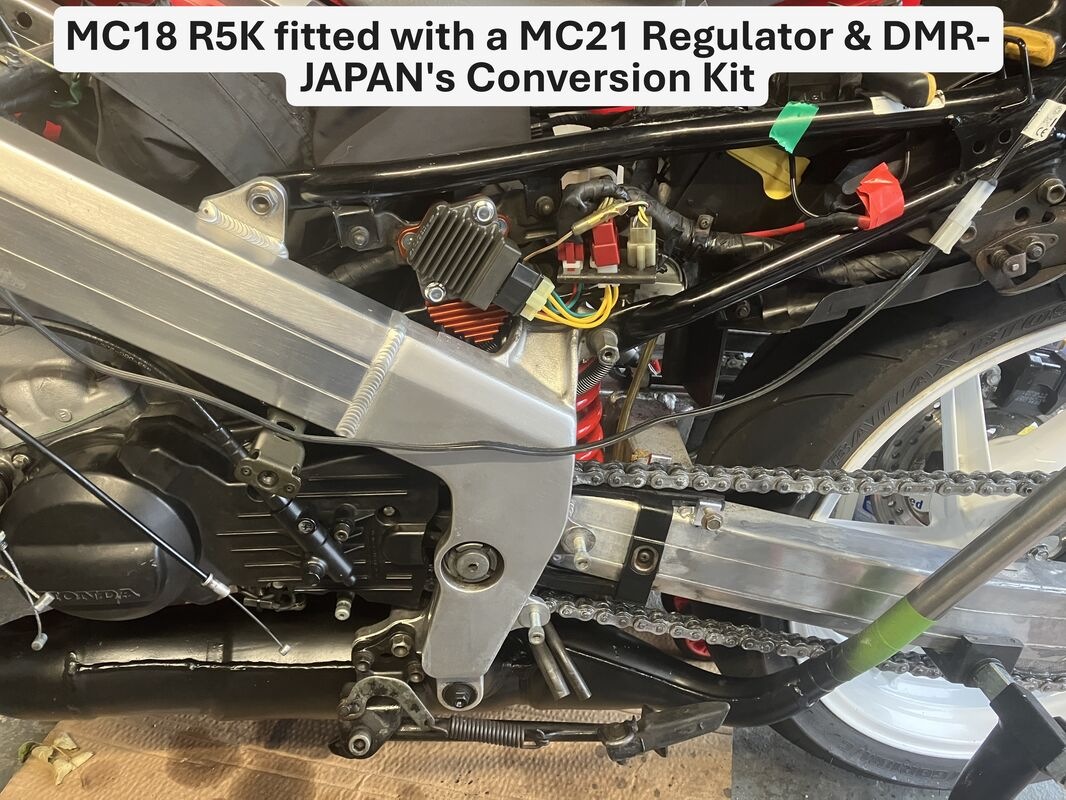

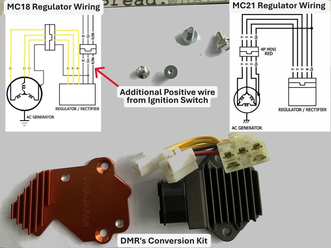

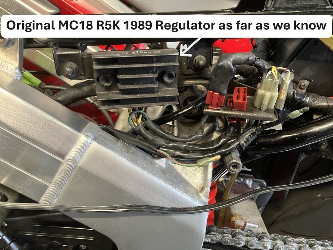

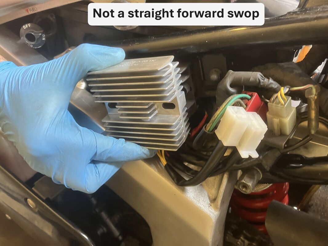

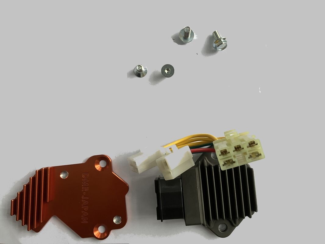

Regulator Replacement

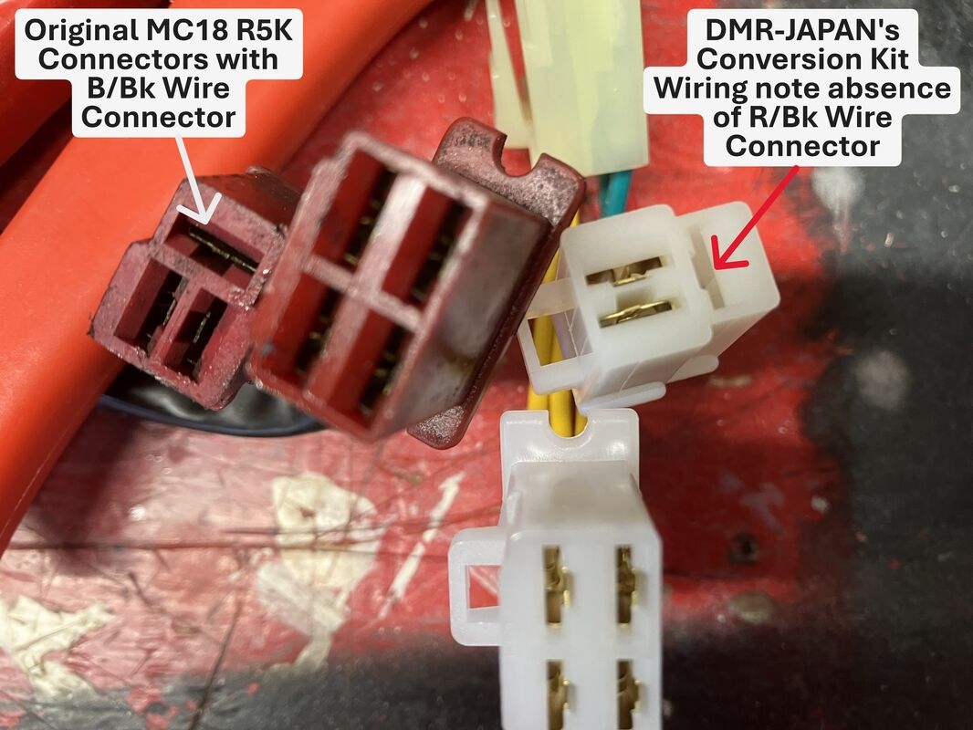

As Honda Regulators can be a little suspect and this one was a bit old in the tooth, we decided to replace the original MC18 Regulator.
Looking around there appeared to be a few MC18 Regulators about including one from WEMOTO which looked a well engineered & robust piece of kit, however, it would require some work to re-locate & fit so decided to give that a miss.
In the end we decided on DMR’s Conversion Kit from WEBIKE which uses a MC21/28 type Regulator & a separate fixing Plate to move its location so that it will fit with very little effort.
However, examining the wiring coming from DMR’s MC21 Regulator conversion kit, there appeared to be a wire missing compared to the MC18 Regulator. Comparing the MC18 & MC21 Wiring diagrams they showed that the MC18 Regulator had an extra R/Bk wire (Positive supply from the Ignition Switch) running to it which the MC21/28 Regulator does not need.
All fully fitted and working fine.

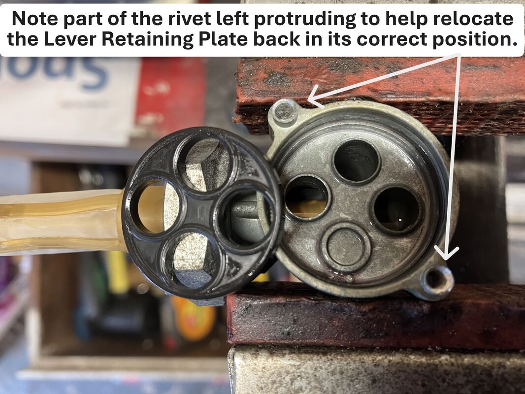

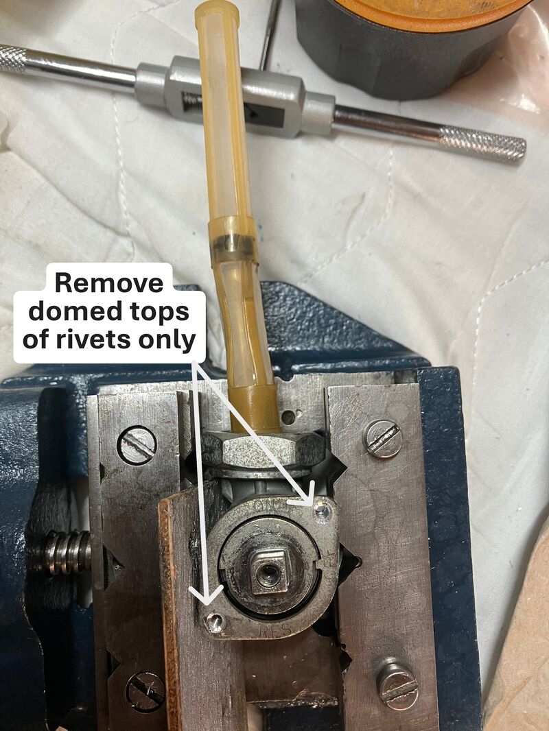

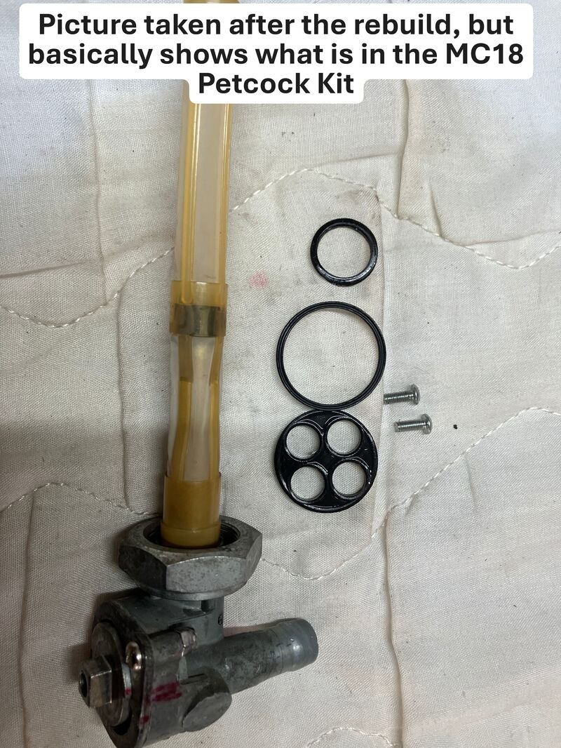

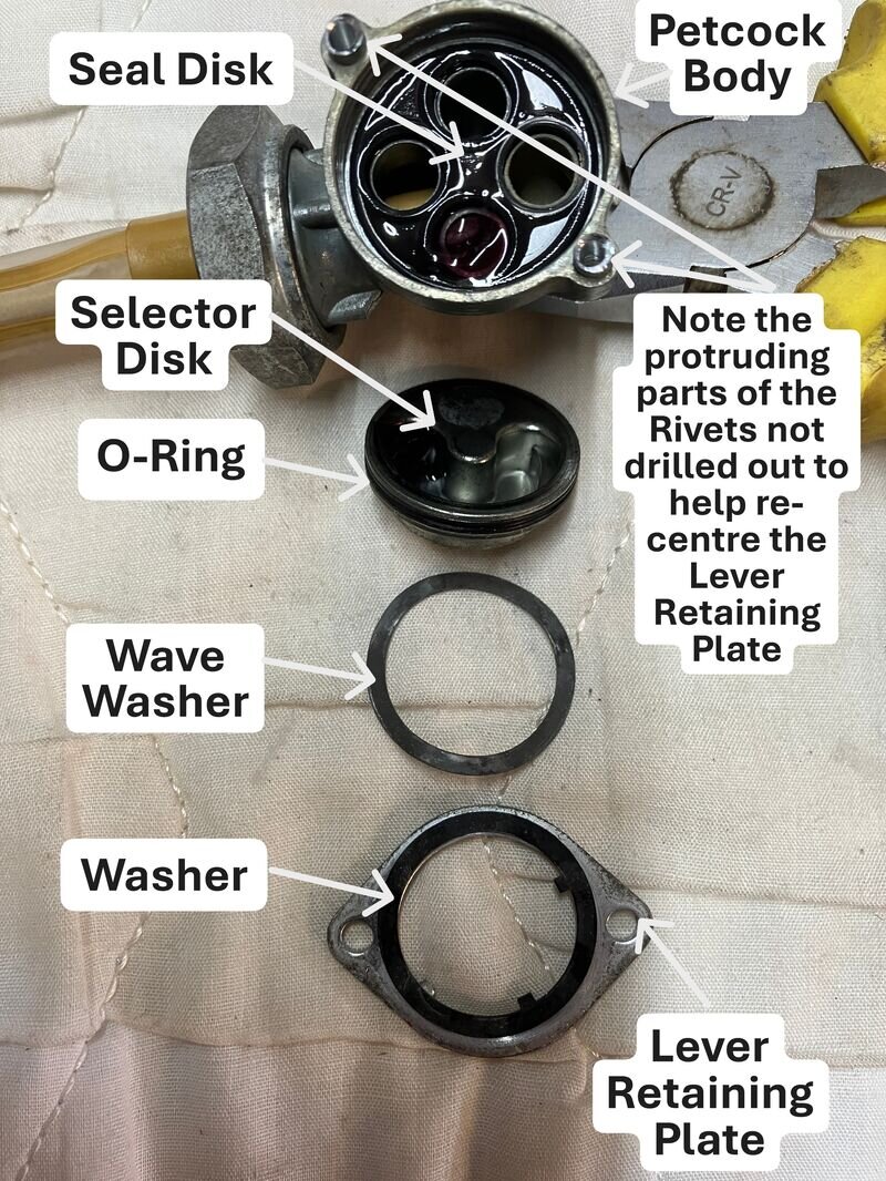

Petcock Valve Repair
Although not strictly part of this re-build I had a spare Petcock Valve from my NSR250 MC18 R2J (the same Petcock as in the R5K) that I thought I would have a go at renovating it (yes, I’m of that generation that hates anything going to waste if it can be repaired). So, I bought a re-build kit from NRP Carbs and Diaphragms, which comes with a complete set of instructions, and set about it with mixed results (mainly from my own wrong doings I might add).
Note: Old Seals are shown below after replacement, but this is what basically what comes in the kit.

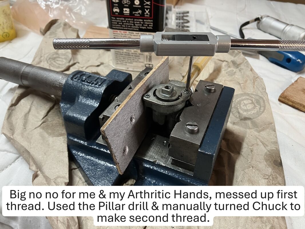

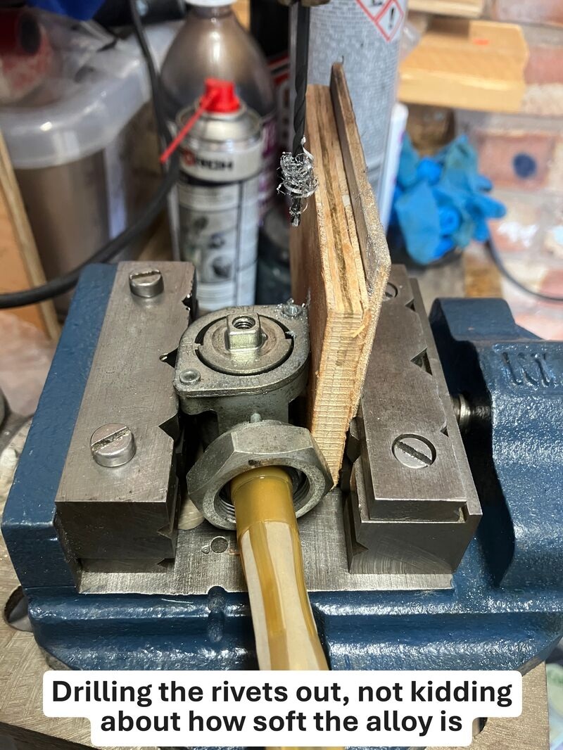

I set the Petcock Valve up in a Pillar Drill making sure it was horizontal in either direction & using a 2.5mm Drill Bit set about removing the old Rivets. I must admit the instructions did warn me that the Alloy was very soft & I had to keep pulling drill bit out and brush off swarf. I lubricated it as per instructions, but was told later by an engineer that the best lubricant for soft alloy was Paraffin (another lesson learnt!)!
Note: Don’t think I was supposed to drill all the way thru, but in retrospect it was a good idea as you will see why later on!
Tried in vain to cut my first thread with my arthritic hands & made a complete mess of it (it’s a 3mm x 0.5mm Pitch thread). Couldn’t maintain a constant pressure and keep the Tap upright so ended up striping what little thread I had achieved.
Second attempt I put the 3mm Tap in the Pillar Drill and with slight but steady downward pressure & turning the Chuck by hand it made a much better thread & helped with the pain in my hands considerably, a WIN WIN as they say.
Rivet heads were removed using a larger diameter Drill Bit leaving the bottom part in the bracket to help locate it later

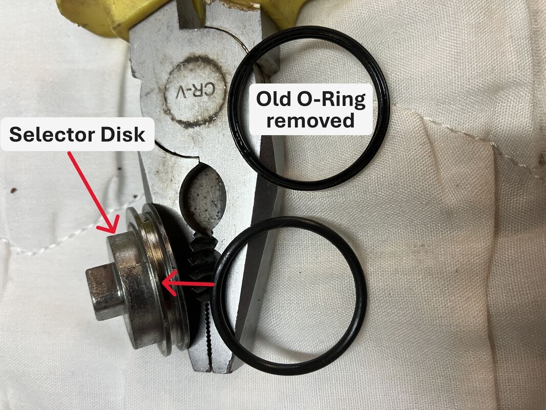

Petcock Valve Repair Cont’d

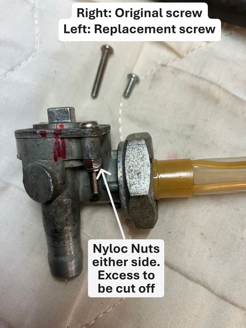

Petcock disassembled showing its constituent parts (praise be to Google for putting names to these parts lol).
New Seal Disk ready to go in.
New O-Ring ready to go onto Selector Disk, although the old O-Ring still looked in remarkably good condition.
All assembled ready to fit.
Note: Original screws replaced with longer ones so that screws not only screwed into the Petcock’s Body, but enabled Nyloc Nuts to be added to secure the screws. I know it’s a bit of a Belts & Braces approach, but I didn’t think my first thread was really strong enough [i](as I stripped most of it) to secure the Lever Retaining Plate onto the Petcock body.[/i]
